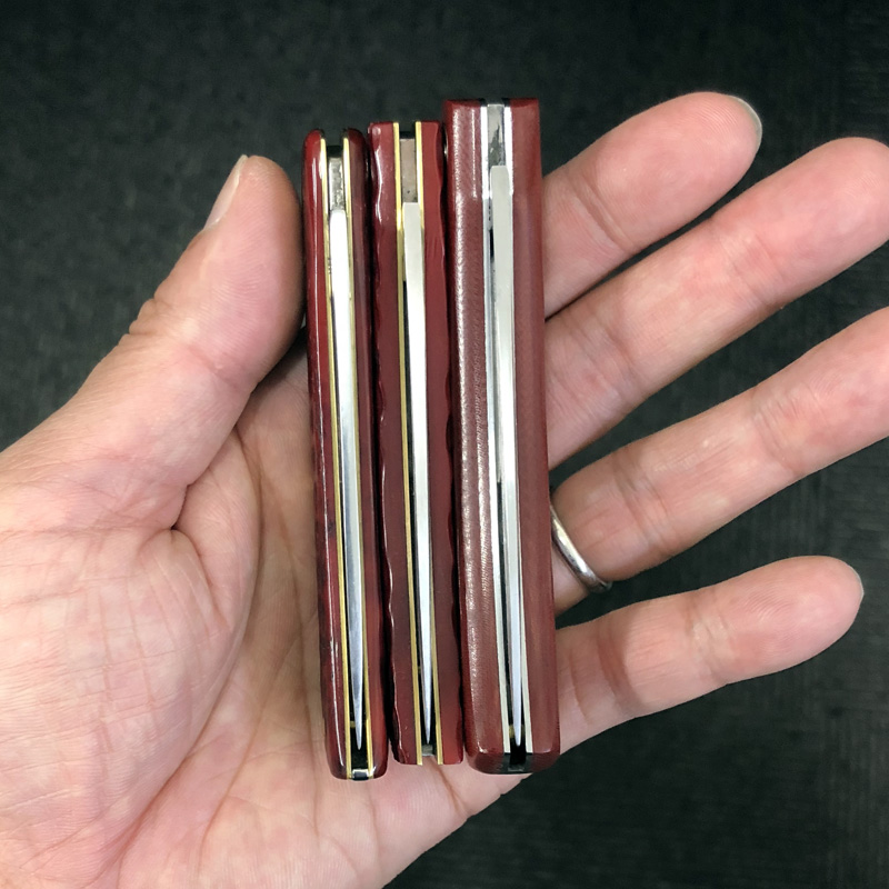

Major differences
Blade steel: 420HC (Case), Supposedly D2 (Queen), 1095 (GEC)
Blade grind: Hollow (Case), FFG (Queen), FFG (GEC)
Mechanics: Cam (Case), Cam (Queen), Half-stop (GEC)
Size: 3.625" closed (Case), 3.625" (Queen), 3.875" (GEC)
Handle thickness: 0.31" (Case), 0.43" (Queen), 0.51" (GEC)

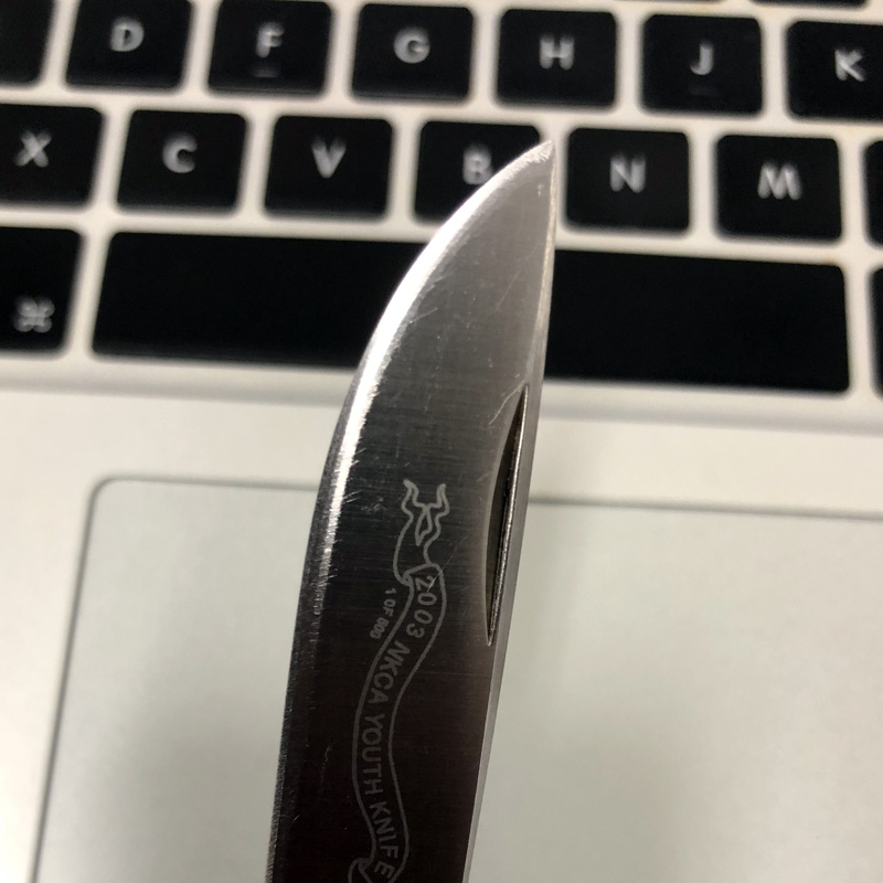

Edit: The steel of Queen might not be D2 but a stainless steel (420HC?). Thanks to Obsessed with Edges Obsessed with Edges .

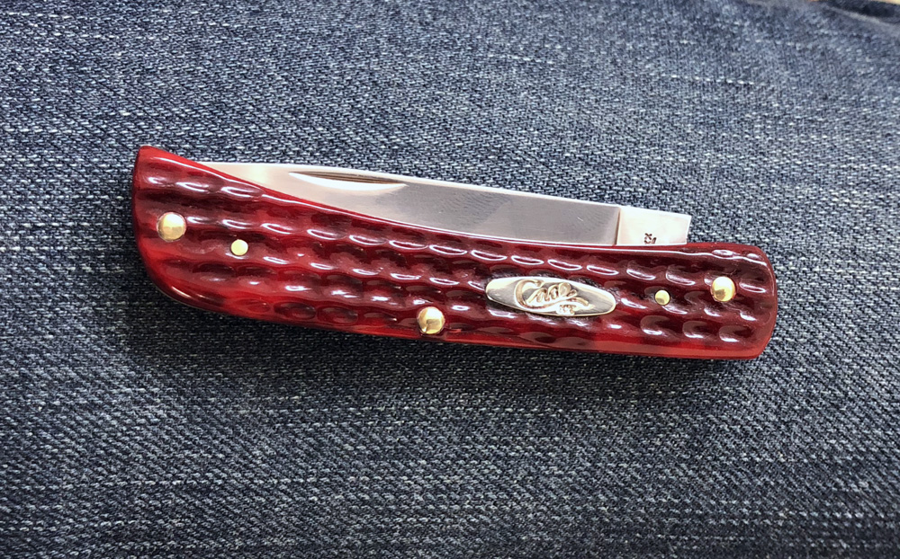

Case:
Good F&F. Really excellent on my sample. Perfect blade centering. Everything except the edge is rounded nicely in this Pocket-worn model.
Thinness. Very pocket friendly. This Pocket-worn model knives seem to be thinner than the original bone handle knives (0.31" vs 0.44").
Blade grind. I was surprised by the full-height hollow grind. This and the thin blade stock makes this knife a real slicer.
Action. Very smooth out of the box. Even better after flushing out grits. The spring tension and preload are just perfect with a pull at 6 or so (with my SAK as a reference at 5). Feels very secure in hand. On par with my GEC #15. And the edge does not hit the spring.

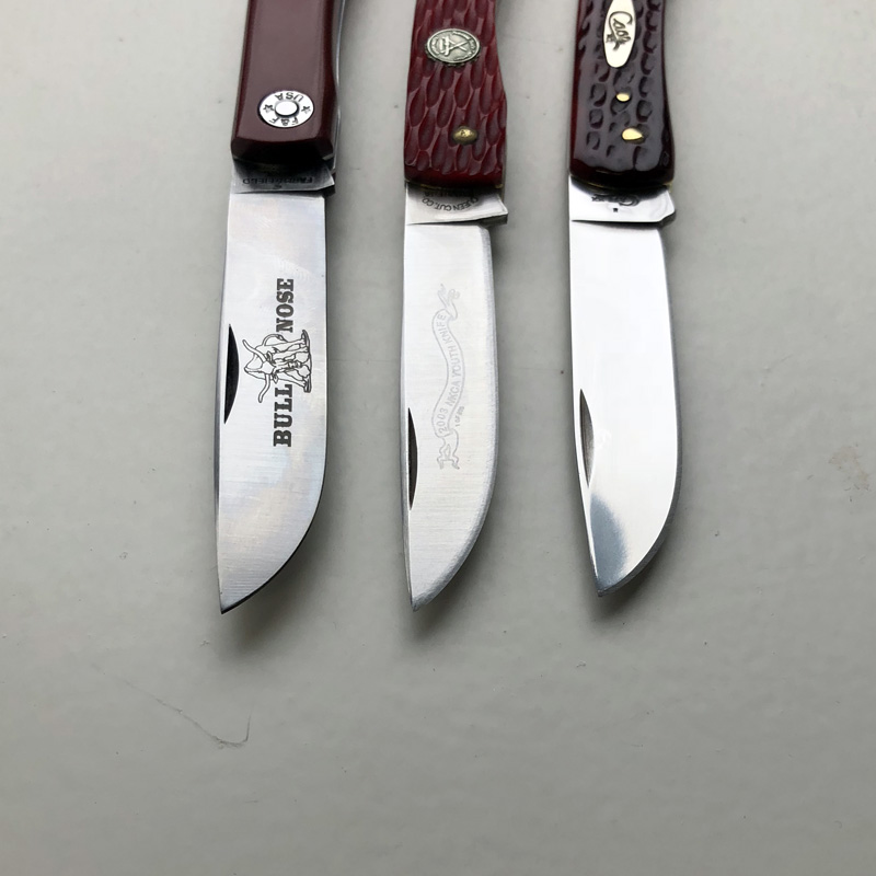

GEC:
Superb F&F.
Blade grind.
FFG to a very thin edge. This knife is also the thinnest among three in the stock thickness.
Action. I like the strong spring. Probably 7 or 7.5. Very smooth out of the box.
Handle. The thick linen micarta handle feels great in hand and secure.

Case:
Blade steel. It would be great if it has something better than 420HC, like 154CM or D2. I got try their CV at some point.
Blade tip. Too blunt.

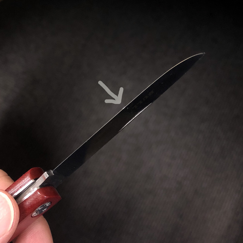

F&F. It's not bad, but could be better. Particularly, the pivot should be little tighter to eliminate blade play. Also, the edge hit the spring before edge reprofiling.
Spring preload. The tension is perfect. The preload is little weak, such that the blade can be pushed too easily from the open position.
Blade grind. I wish it has a better deeper grind to a thin edge. I had to reprofile the edge heavily to make it work right. It now has a wide convex edge.
GEC:
Handle thickness. It would be perfect as a work knife. But for EDC, it is little too thick and bulky in pocket for me.
Blade. The tip is too close to the edge of the handle. Yet, the blade edge is too close to the spring and hits it. I have to take the tip down soon.

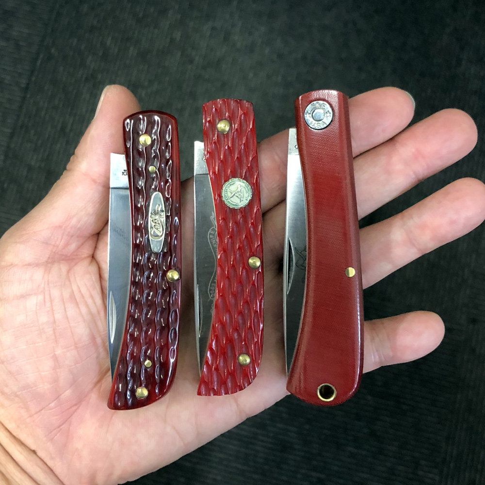

Verdict
To me, Case Sodbuster Jr. is the winner.
The thin handle and thinly ground blade seem perfect for a pocket carry.
Particularly, this Pocket-worn model feels more refined and like a good gentleman's carry.
I need to see how I like it in actual use.

It is a NKCA year knife, which is based on Country Cousin, but I can't find the definitive steel info of this particular model.
So it's a guess.
Might not be D2. Looking around at other sites offering these for sale, some advertise the 2003 NKCA Youth Knife in red bone as 'stainless steel' (which D2 isn't), and still others also show these 'NIB' knives in boxes marked 'Queen Steel', which is how Queen classified knives made in stainless steel, rather than D2. 'Queen Steel' was 440C since post-WW2 (still probably in 2003), and maybe 420HC later, not long before Queen closed their doors.
In boxing the D2 knives, those were normally labelled as 'Tool Steel' on the boxes, if other markings like the 'Tool Steel' etch on the blade or the 'PH-D2' stamping on tangs were omitted or replaced with different etches or stamps.
Whether D2 or not, yours is a nice one, and good review as well. :thumbsup:
The knife did come in a box with "Queen Steel" printed.
I don't have any other D2 blades, so I can't make a comparison.
But the blade seems pretty stainless.
Since the knife was for a "collectors" association, they might have wanted it to be stainless?
I read that Queen has used 440C, 420HC, and ATS-34, and hope that it is the last one :)
