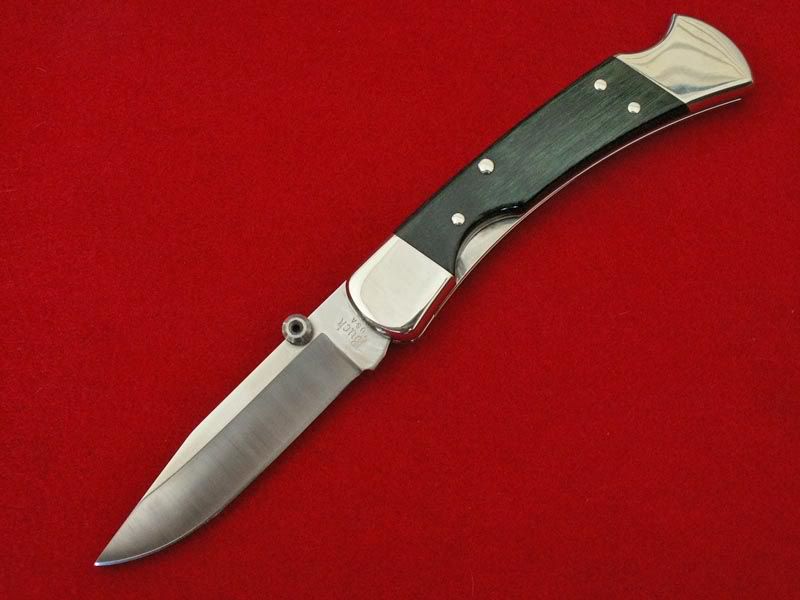

I've tried thumb studs on both the 112 and 110 and found that, at least for me, the spring tension is too much for me to comfortably overcome. If you check out the models that are designed to be one hand opening, you'll find that they have much less spring tension (snap, opening or closing) and I believe that's they way they're designed.
The only 110/112 that I've ever found easy to open using a thumb stud is the ill fated 110 Liner Lock from around 1997. It has a noticibly weaker spring and no "snap" when closing. I have two of them, unused and new in the box, so it can't be that they loosened up with use. They seem to have been made with a much weaker spring than the standard models and I think that was by design, to make them easier to thumb open.

The Buck shown in the pic with a liner lock and stud looks so sweet. I have never seen one like that before.
Very nice, thanks for sharing your pic.

In 1974, Buck increased the spring pressure on the 110's (two dot's) to keep them from being labeled a "gravity" knife. Perhaps the 110 that you had was one that was made before the change.
The liner lock 110 was produced in 1997 -1998 and was a Wild Bill Cody design. It's said that less than 350 of them were produced as a "limited production" not a "limited edition" and they came with the thumb stud installed from the factory. I seem to recall reading that they didn't continue with them because they required so much hand work to build that they weren't practical to produce. It appears that they were never listed in the catalogs.

That one you show in the pic is a great looking piece. Really to bad they didn't continue making those.
Your a lucky guy to have 2 in your collection.
It would be really nice if there was someone out there that could turn a factory 110-112 into the same knife as yours, but probably would be very expensive to say the least. Your rare Buck 110s are sooo sweet.
Yeah, I'm sure that Leroy Remer or Wild Bill could duplicate the LL but I'm also sure it wouldn't come cheap. I guess I am fortunate to have two of them.
