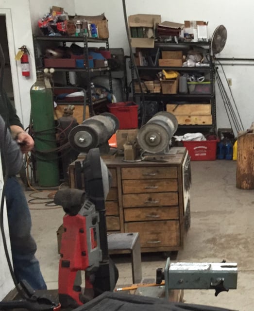

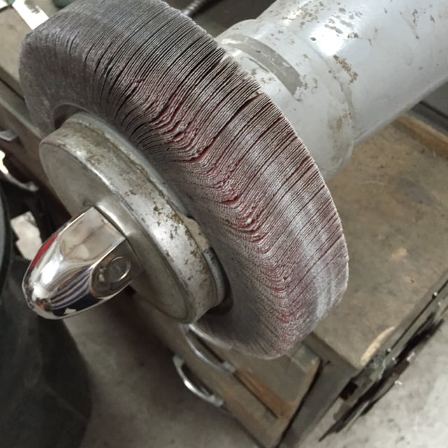

I use- UNMOUNTED 8" X 1" X 1" WHEEL on my Baldor 1800 RPM buffer/grinder machine.
here is a pic in Murray's shop
With the flap disk, are you holding the blade vertical? How do you keep the plunge clean if you are?
i run the flap wheel and buffer in the opposite direction, away from me.
I know that's considered a big no-no here so I'm not going get into the why or how that works for me
I hold the blade horizontally on the top quadrant of the wheel with the blade edge away from me.
