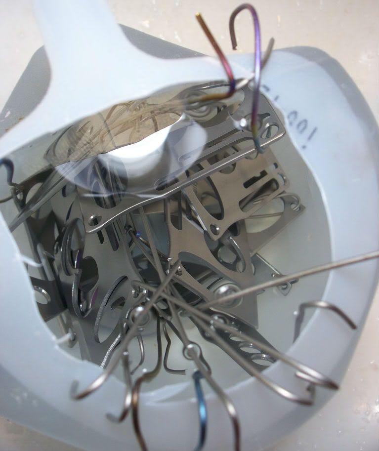

I'm anodizing some stand offs and I need some thinn (paper clip like) titanium hooks. I can't seem to find any place that sells such a thing. I was going to use a titanium tent spike but they are too thick. Any help would be great!
Try 6al 4v filler rods for welding you can get them around .030-.055 on ebay. I buy them from my local welding supply.

I take .040 Ti and cut a piece about 1/4" wide then take the band saw and cut 2 slits in it,bend them around into hooks and grind the points down small enough to fit in my stand offs.
Also for anodizing I us a saturated mix of TSP and distilled water.You can get TSP at most any hardware store in the cleaner section.

Thanks for the help guys, my cathode can be any metal right? like a paperclip or something? and any other tips to keep me from zapping myself would be appreciated!
I use aluminum foil for a cathode, I make a small disc of it to fit the bottom of the bucket. Anode and cathode must never come in contact with each other! Don't grab both leads at the same time.

I use a glass mayonaisse jar, with a sheet of heat treat stainless foil all the way around the inside for a cathode. Then I put a piece of plastic shelf liner inside of that to insulate it from the anode or pieces that I'm anodizing. Solution is saturated TSP. PArts are hung on hooks cut from sheet of titanium. Since most systems are using low amp DC, there really is no worry about getting zapped. I use a DC converter that allows me to go to about 100 volts, but the amps are in the 0.5 range. Not enough to feel even if you grab both ends. Think about what happens when you put your thumb across the contacts on a 9 volt battery = nothing.
The large cathode gives a very even color, and using stainless foil means it will outlast you.

I use a square plastic basket in a container for my set up. Phosphate free TSP and distilled water for solution.
Anodized Ti
Here are the hooks I made from Ti wire, I'm rinsing them in distilled water in this pic... they are in line for anodizing.
