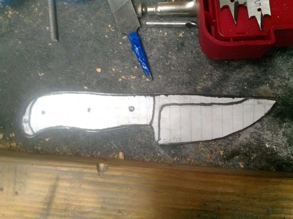

My very first task from Todd was to design and draw out a knife to size and spec so that he could know what size of stock we needed. I wanted to put a lot of thought into this so I first gathered up some of my favorite blades, looked to some of my favorite makers and designers, and even looked to historical pieces for inspiration and started drawing. As you can see in the pic below I began with a Becker BK15 type knife because it represented to me what I was kind of looking for. From there I added in the inspiration from other makers, blades, and even my 3 year old gave her valuable opinion. You can see the evolution below, warning I am not a technical type of artist or photographer at all LOL.
I finally settled on this certain design, (The one on the bottom) e-mailed it to Todd, received some valuable feedback and some lessons from him, and finally applied that feedback to my design. There are a lot of reasons why the knife ended up the way it did, but to make it short and concise I essentially designed it after my experience, and built it around me and my usages. If anyone has any questions about it I would be more than happy to answer.

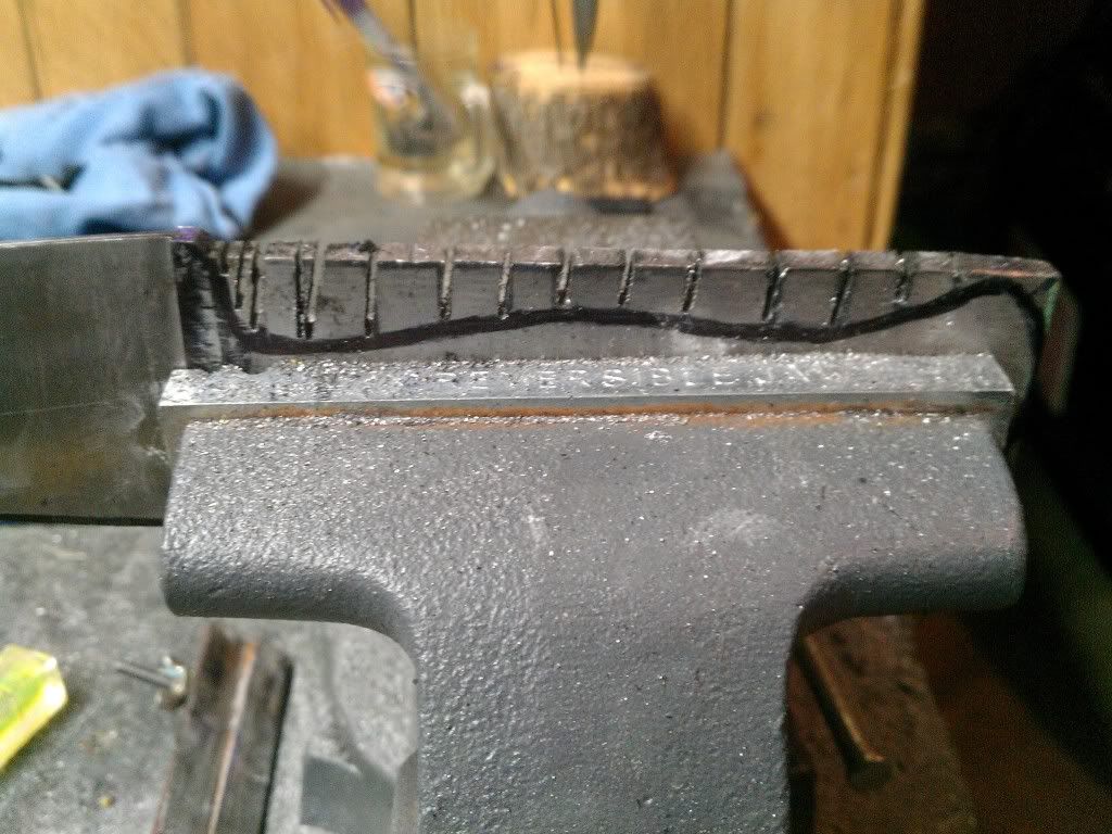

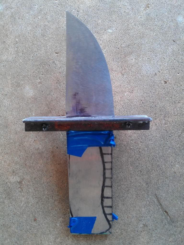

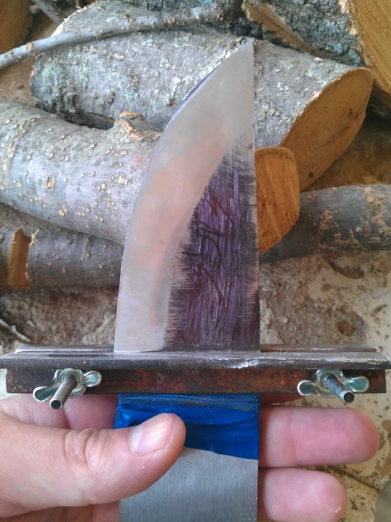

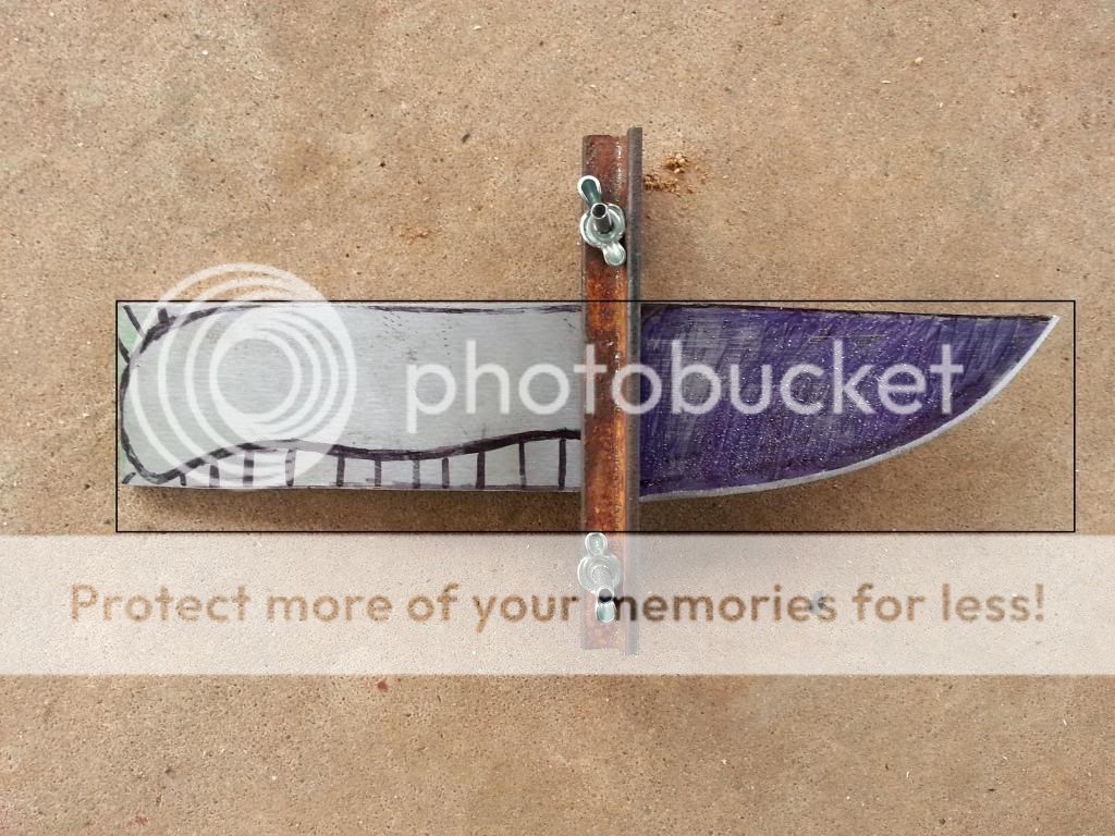

I also decided to make a file guide out of some angle iron I had laying around. It worked out pretty good. Here I made a rectangle around to kind of illustrate what was removed since I don’t have a before pic. It’s pretty close although not exact.

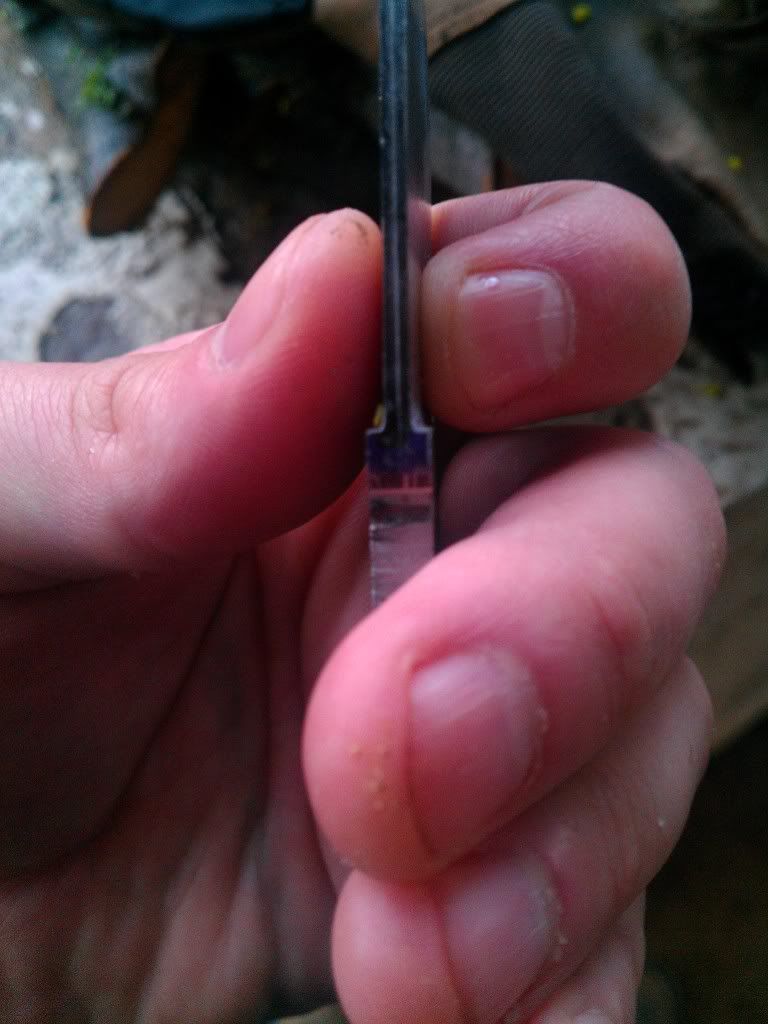

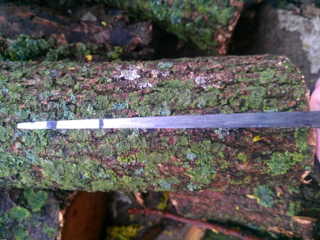

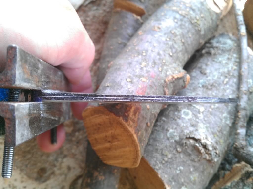

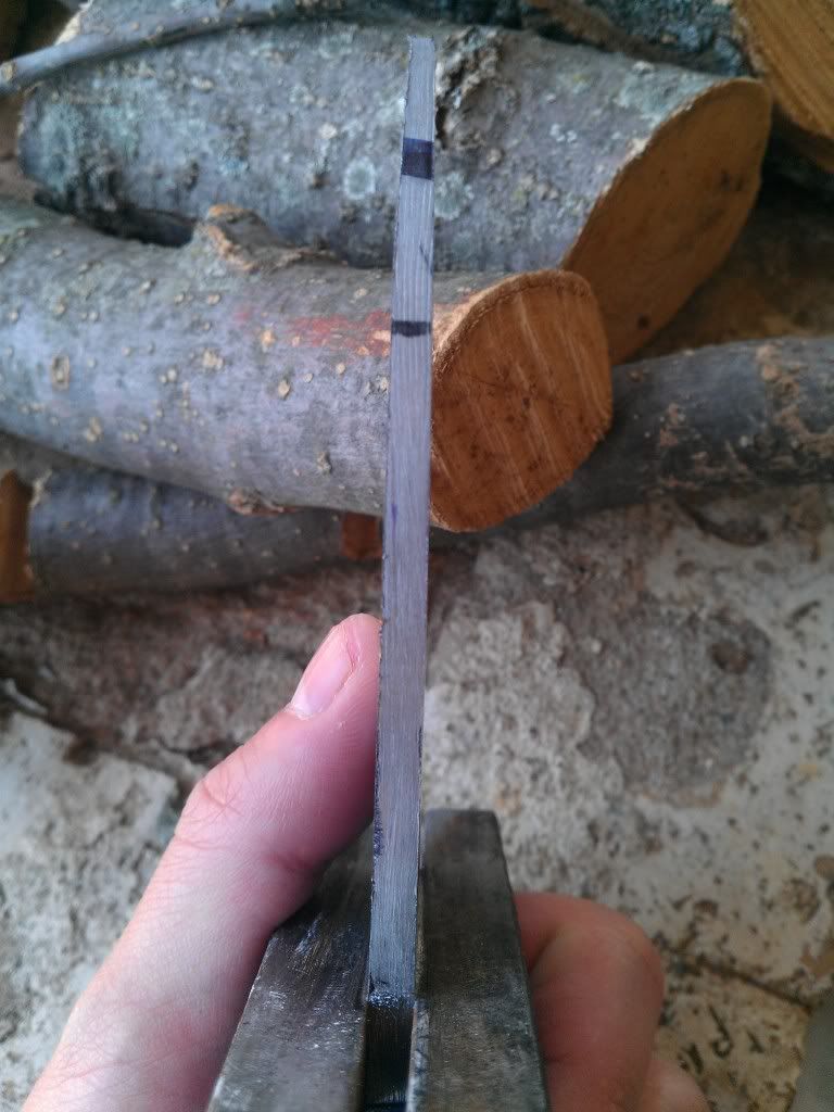

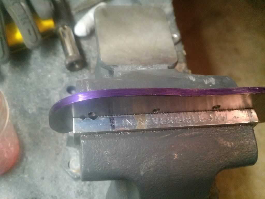

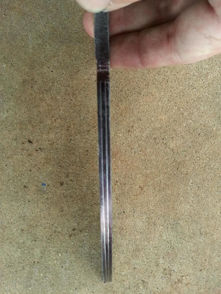

You can see where the purple marker has been backed up to illustrate the progress. Here is an edge shot. Then a spine shot…
And finally the other side…
As you can probably tell from the edge and spine I still had a lot of work to do! FYI I am aiming for a full flat grind and on a knife this wide at 3/16ths” thick, it’s a lot of filing. ;) But a lot of fun.

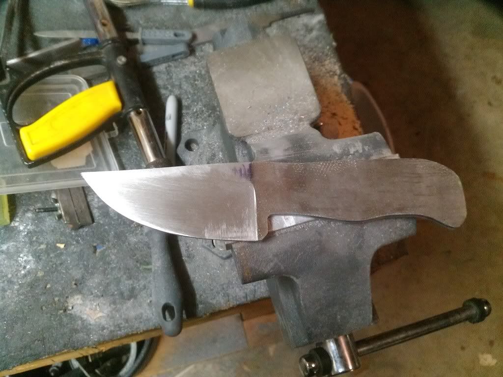

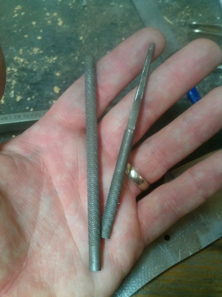

For the next session I acquired a 12” Nicholson file and man did it make the difference I needed! It was like night and day! Here was my progress after a little more filing. Also, you hear knife makers on the forums talk about file cards etc… It is VERY important. For some reason when cutting something this wide I was CONSTANTLY getting little pins of metal in the file. To remedy I just used the file card, another type of brush, then I would chalk the file well. The process was like this, file for a minute or so, file card, bristle brush, chalk, file some more, repeat! It takes a second or so, but it makes a world of difference in your work.
Down to about 1/16” at the edge, more taper in the spine etc…

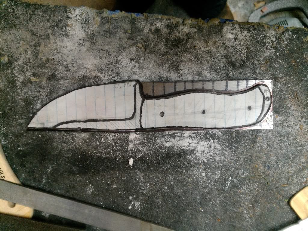

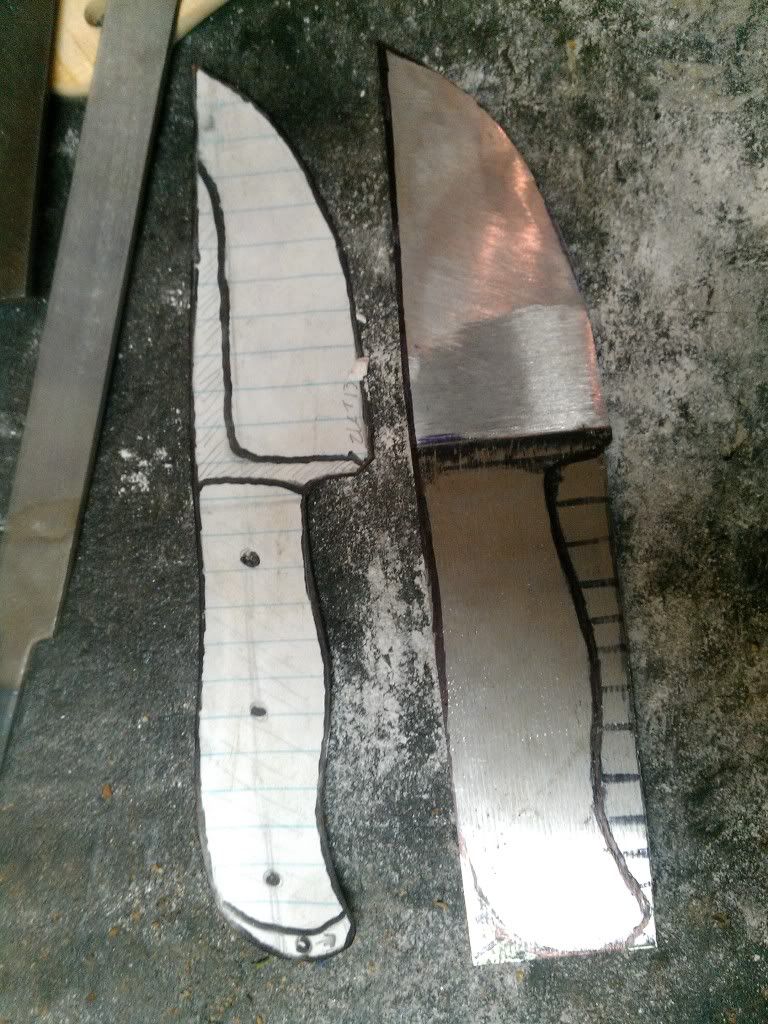

First I rechecked everything with my template and marked it all again. I also marked some relief cut lines. These are VERY important. It allows you to contour your shape and makes your life 1,000Xs easier getting everything cut out. Notice the chalk and metal shavings all over everything? LOL

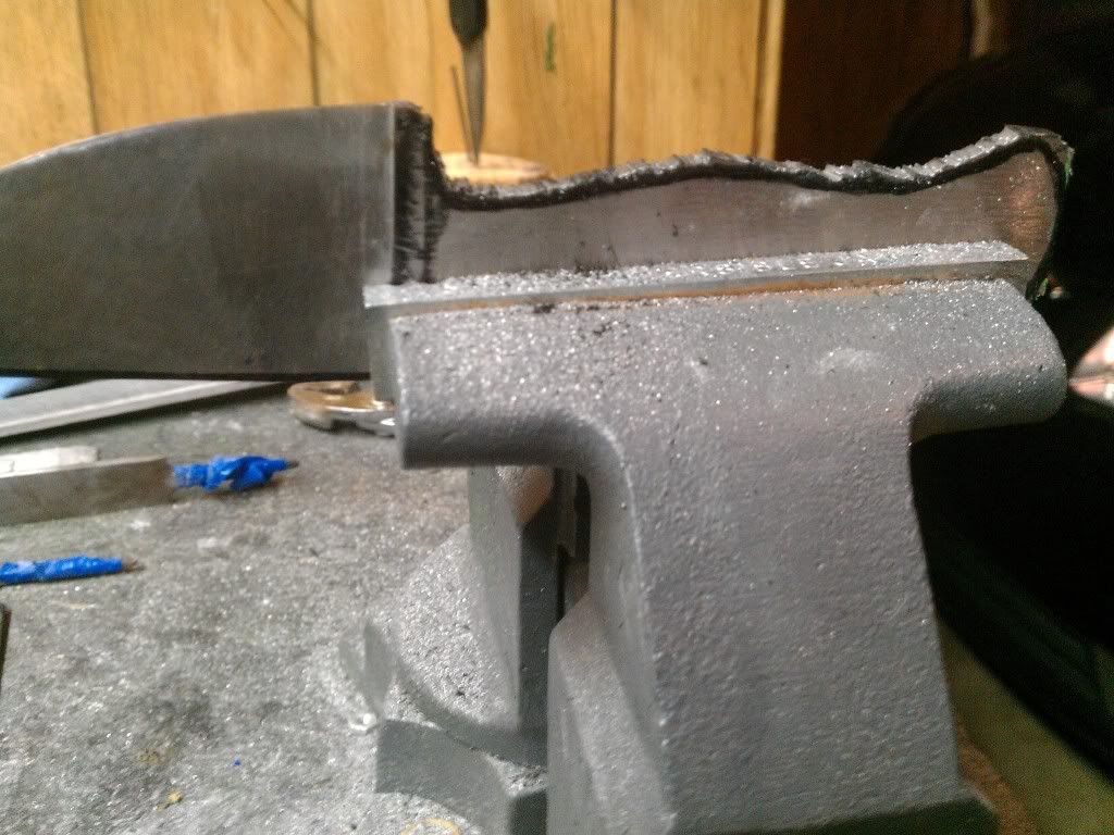

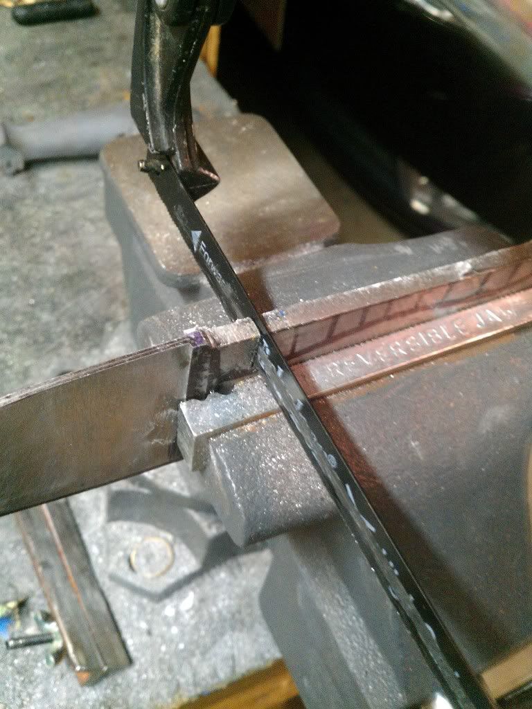

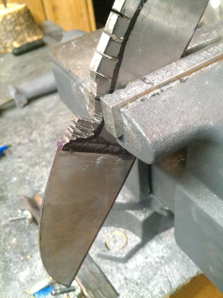

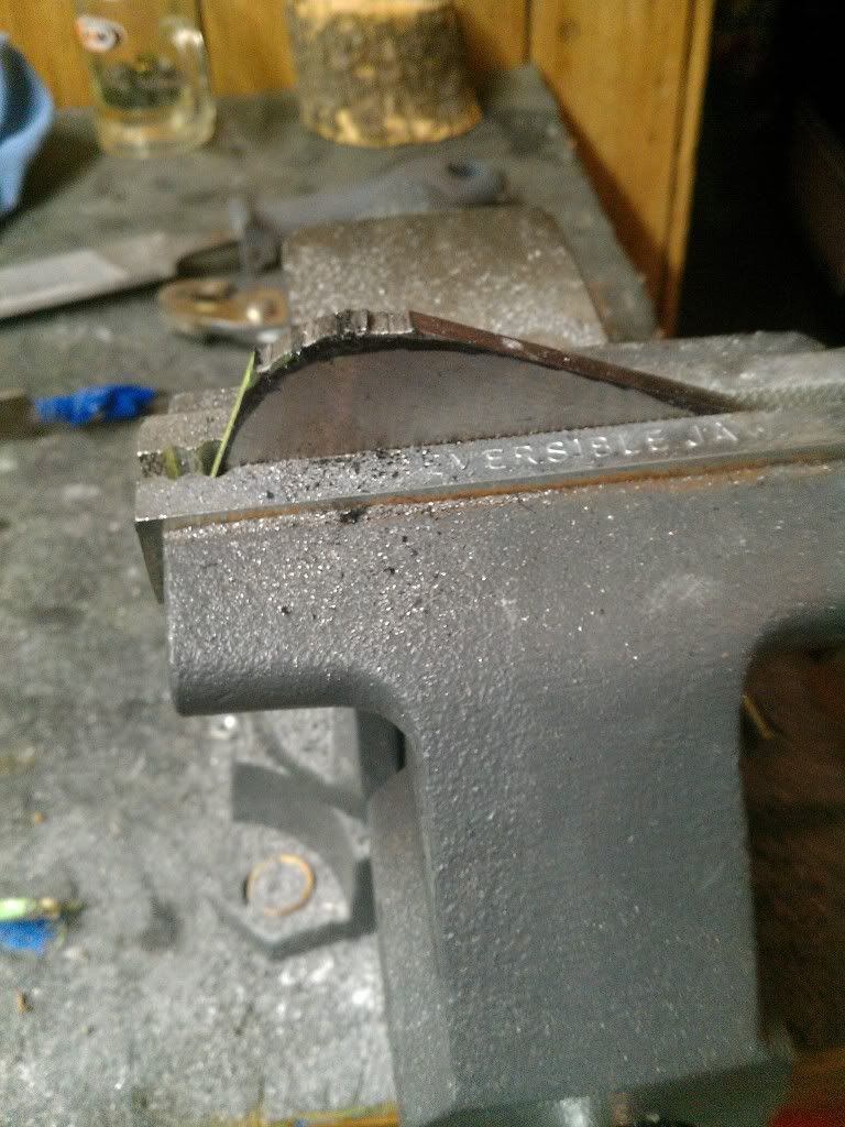

Here I put it back in the vise, and start cutting. I probably went through 4+ blades getting the whole blade cut out. Although they were not completely shot, when they started to not cut easily I just swapped them out. If you have ever cut something metal out with a hack saw before you know what I am talking about ;)
Relief cuts galore!
Now I just edge my way into the cuts to remove the material bit by bit.
Here you can see what I have accomplished after a little bit of patience and elbow grease. From here I actually will go back and try to cut out as much as I can with the hack saw. It is easier to cut out all the high points with the hack saw then try to attack them with a file IMO.
Here you can see how it looks after a bit of filing to get all the hacksaw marks out and get my desired shape out of the steel. By the way… all the metal you see is only from that knife. In fact that vise was brand new and this knife was its first project.

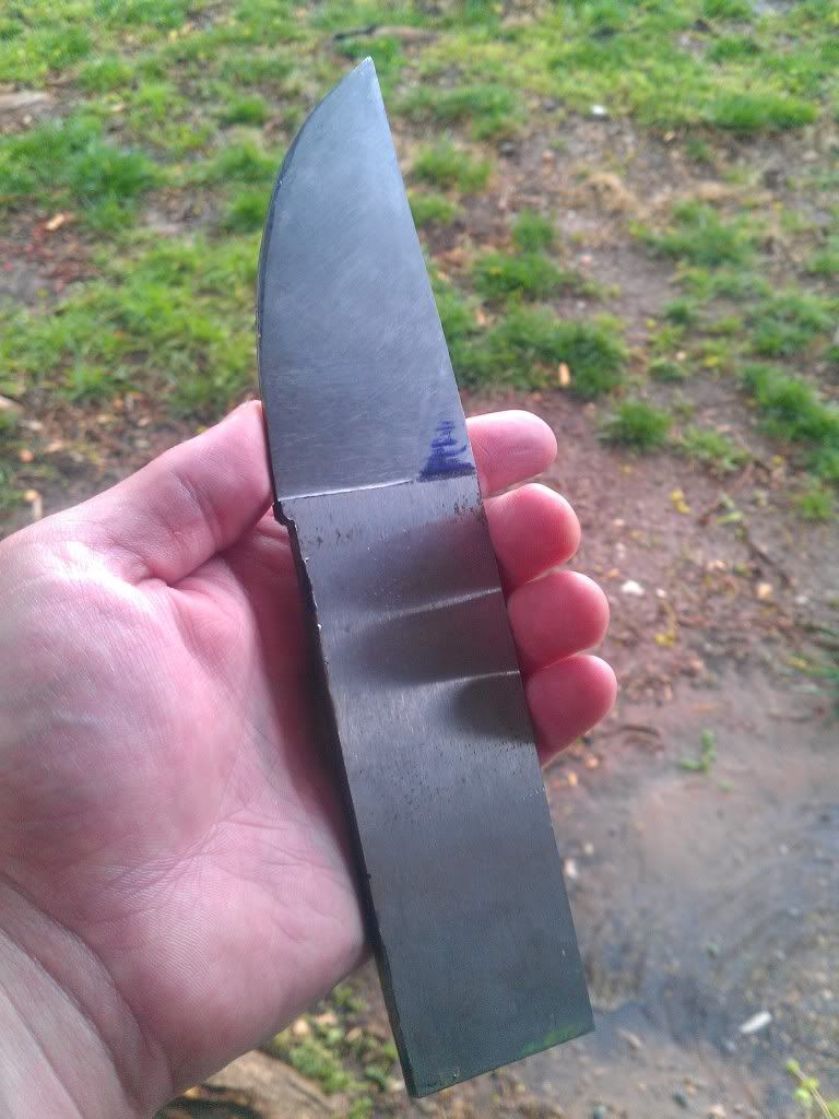

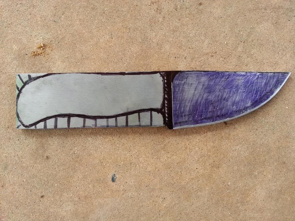

Well here is where I stopped for that night. I still have a lot of material to remove to get my shape. I think it looks pretty cool here but overall the tang is way too wide lol.

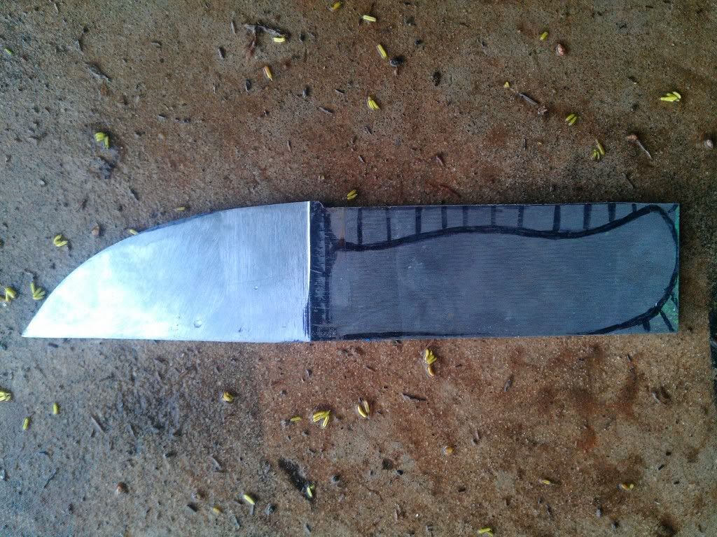

Alright we will flash forward through time here a bit, but here it is after a lot more shaping to the tang. I was telling Todd that I think getting the right shape out of the tang has been more work than anything else so far. It seems that last thousandth of an inch takes forever to haul off lol. I also added my pin holes. I wanted the handle shape closer to spec before drilling the first holes because I wasn’t sold on a particular configuration yet. In fact as of this moment I am still trying to figure it out. All I know is that those two holes have to be there, or at least I have convinced myself of that! I am either going to be adding 4 more holes… or 1 more. Dunno its up in the air now, but here it is after a little more work. I have also draw filed on the grind a bit to get it closer to spec too.
Here is a lay-over with my template. I am actually closer to spec than it seems in the pic, but the edges are starting to roll up from all the sharpie.
And finally here is a shot after I marked up the blade a bit to show kind of what I am shooting for. I still have some more filing to do on handle/tang, decide on what to do for the pins, then drill a lanyard hole. Kinda looks like a knife doesn’t it?

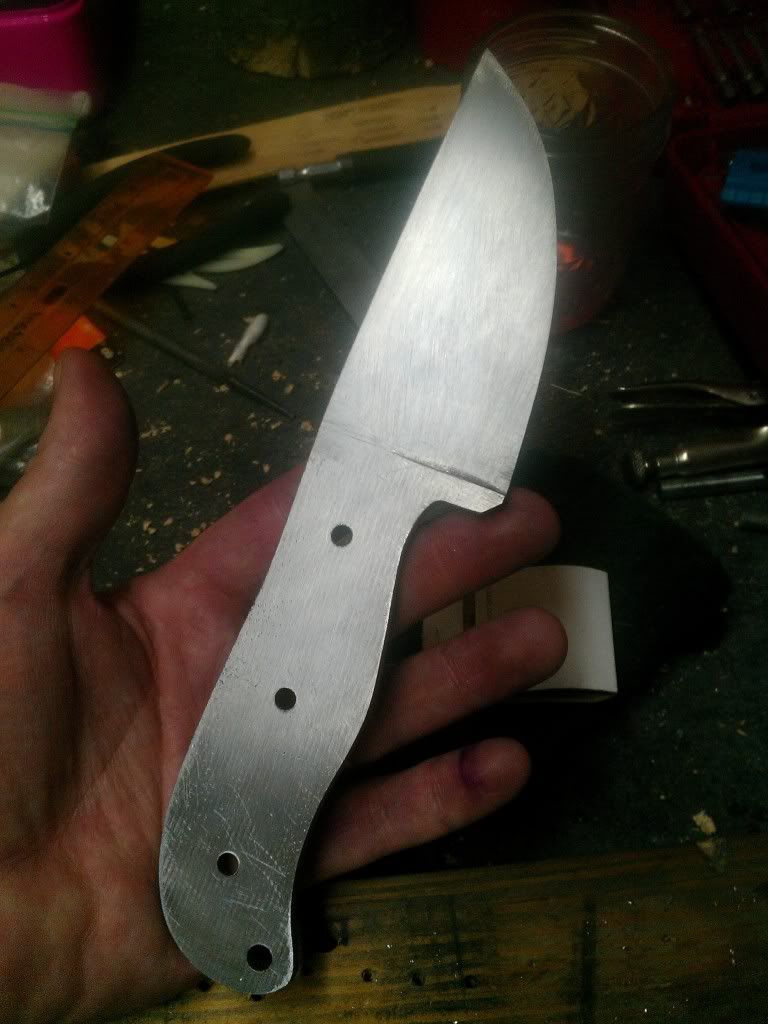

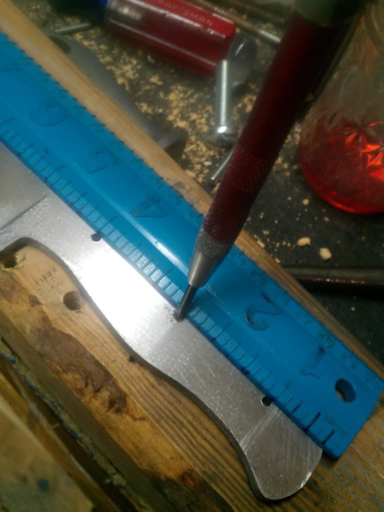

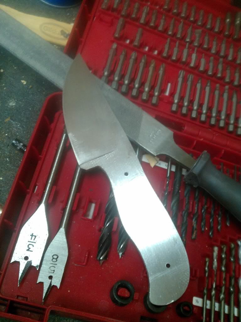

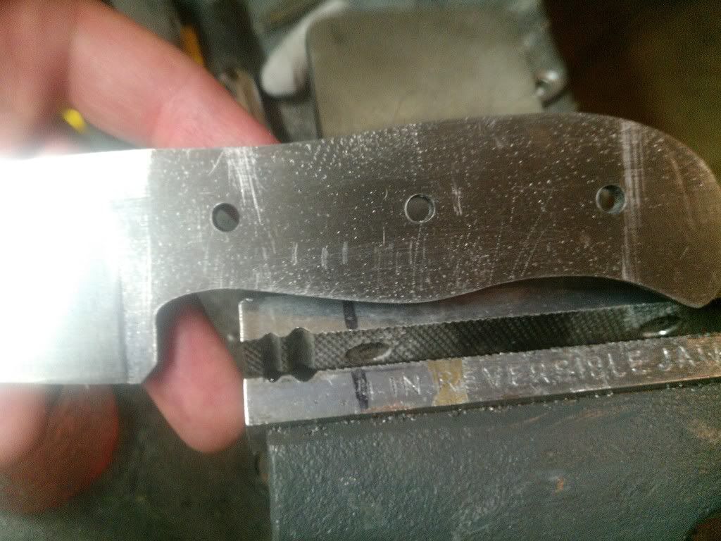

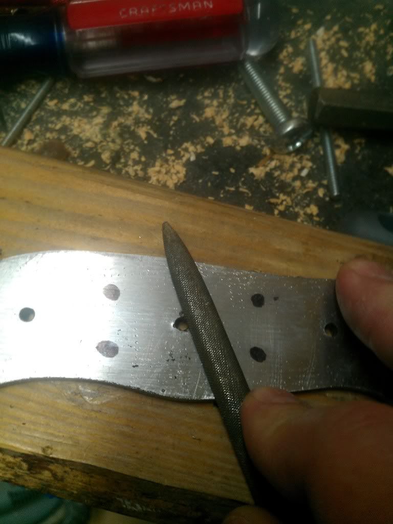

Well, no sooner had I posted about messing with the pin holes had I devised a plan. Basically there is a slight offset between the already two present pin holes so I didnt want to add a third in the middle, but when I bumped the hole size up to 3/16ths" its pretty much not noticeable. So off to the garage I went!

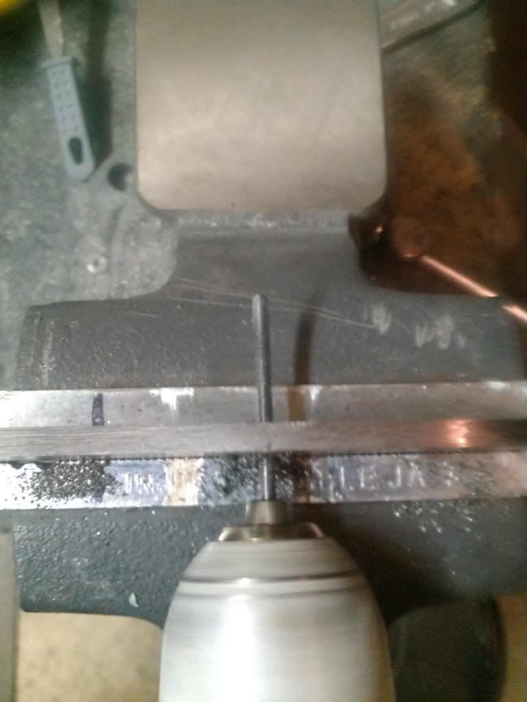

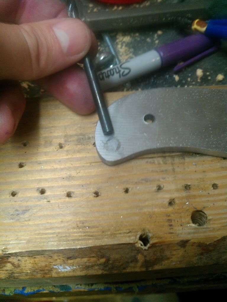

First I measured the distance, found my center, and hit it with my auto punch to mark. If its good to go I give it a couple more hits with the auto punch.
In my experience drilling metal an auto punch can work well but when you want to be really specific you have to go old school. So I gave it some good raps with a larger punch.

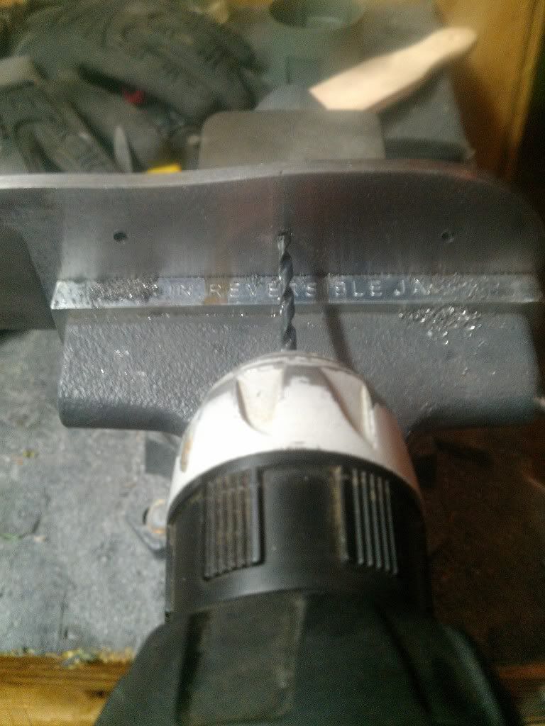

Now commence the drilling. I started with a 1/16" bit to start my hole, then bumped to 1/8", then to 3/16."
After drilling I cut off the bur with a little half round detail file.
Viola! I am a happy camper. Even the little things with this project make me happy.

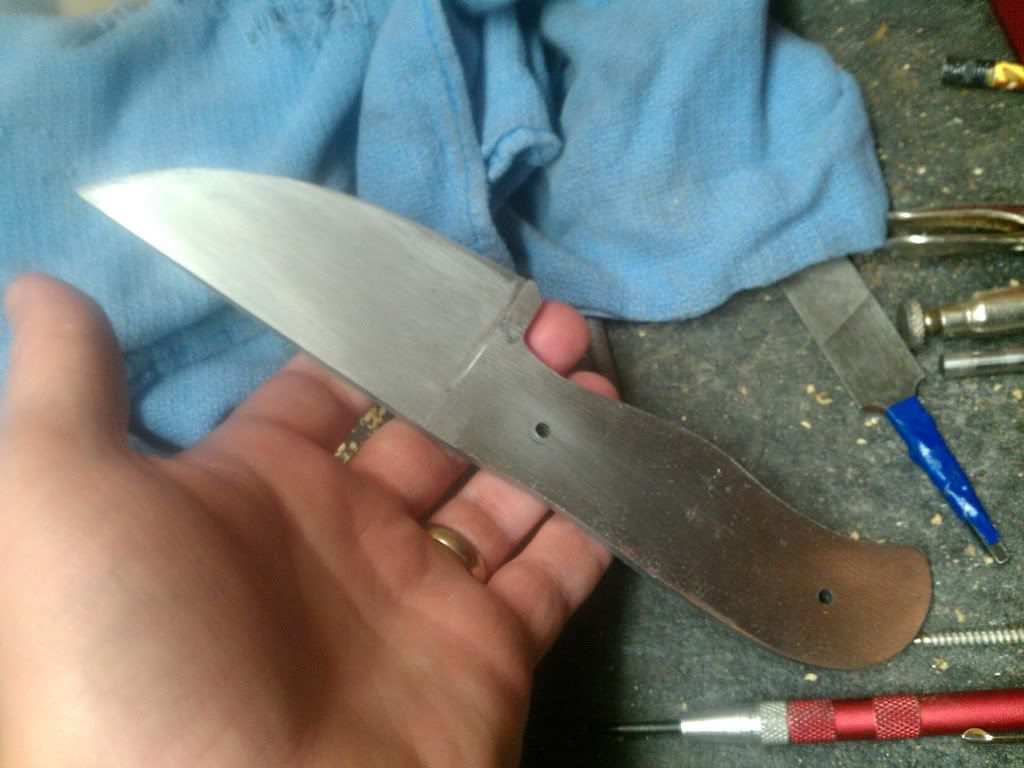

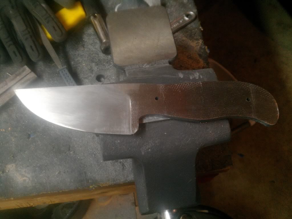

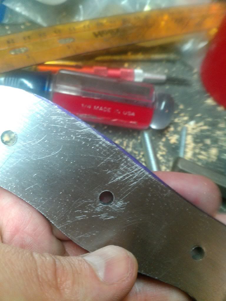

Next I remarked the tang against the template. If you can see the purple line there is an area I have left to remove.
Before filing I like to mark up the area I am working on to make sure I am cutting true. Basically I ended up dressing out all edges a bit more tonight.
Next I measured and mark for my lanyard hole. We have decided on this placement for a couple reasons. I am going for an exposed pommel and I didnt want the lanyard to be in the way. Plus when using the knife in a extended fashion with the butt against your palm I didnt want to fight the lanyard either. Plus some other reasons but I think you kinda get the idea.
Holes are drilled.
Well that is all I have for the night. It might be a couple more days before I update next due to the weekend. On this build we have suffered one casualty so far, but let no man be forgotten or left behind. Poor round file never saw it coming. The knife, not even heat treated has already made its first cut!
