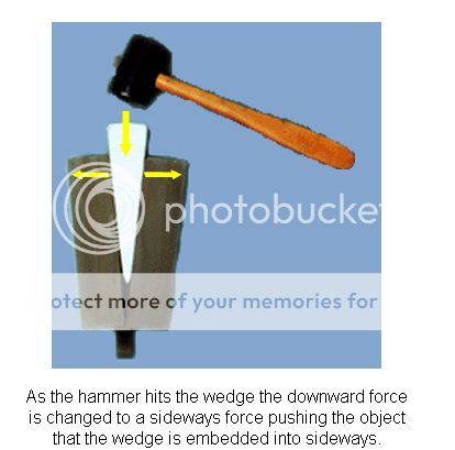

Personally I don't see any advantage (but I do see lots of disadvantages) in 'splitting' for a wedge as opposed to cutting of a groove. You have control over the straightness, depth and direction of the kerf when you use a saw and you can mark on the wedge (presuming this too originated from a saw cut) the point at which it will bottom out. With a split you have nothing except for a fervent prayer that the haft fits snug enough not to see the split carry right on through into the haft as the wedge goes in. Folks drill relief holes at the end of glass, steel, fiberglass and iron cracks to keep them from extending further; a saw cut kerf is/does exactly that if the wedge tip is trimmed/blunted to be equal thickness of the kerf cut.

I agree with this sentiment. A split kerf represents a separation of the wood fibers, and it terminates in a way that can deepen and worsen, potentially causing issues later on. It is inducing weakness in the handle and I would use the method only if I had no other suitable means to haft the axe. A saw-cut kerf has effectively removed material without straining the wood or introducing cracks, and will have a built-in means of preventing over-penetration of the wedge, as mentioned. Splitting is inherently riskier with little gain over sawing.

A saw is like a series of tiny chisels. They are cutting material and removing it from the kerf rather than spreading the wood and breaking the bond of the fibers that remain in the workpiece. The means of preventing over-penetration of the wedge is as 300six describes--a flat tip to the wedge corresponding with the flat bottom of the kerf. Once the wedge reaches the bottom of the kerf it is halted and cannot continue.

Be careful though because 42's point about the kerf being a fail safe is only partially true-- a thick wedge can start a split before it even reaches the bottoming out point, if the tongue of the handle is poorly fitted to the eye.
Yup--definitely. If the wedge is too thick then you can still split a handle even with a sawed kerf. :)
I think that's why the general rule is only cut the kerf 2/3 the depth of the eye. This allows a tight fitting head to prevent possible splitting due to a thick wedge.
You can also split or crack the eye and as for a wedge being stopped by the bottom of a sawn kerf, I will definitely call you out on that one FortyTwo.
Well, you have to be sensible and not keep mashing it in there after it stops going any further. I'd hope that would be obvious. But it does halt the progress of the wedge from being driven too deep and causing cracking below the head, again providing that you didn't make the wedge too thick in the first place. It is an additional degree of safety provided by a sawed kerf that a split one does not afford.
Once again some great discussion however if you think about the bottom of a kerf, the wedge should not be able to be driven that far, it should do its job before that point and never quite reach it. In my experience, if it does, then the wedge should be thicker because either the wedge or the sides of the kerf are compressing enough to allow the wedge to bottom out. That should not be allowed to happen and there is no real advantage in having it bottom out. Sure there is the argument that filling that little void is the ultimate but for the percentage difference it makes to the overall effectiveness or resilience of the axe, it is negligible.
