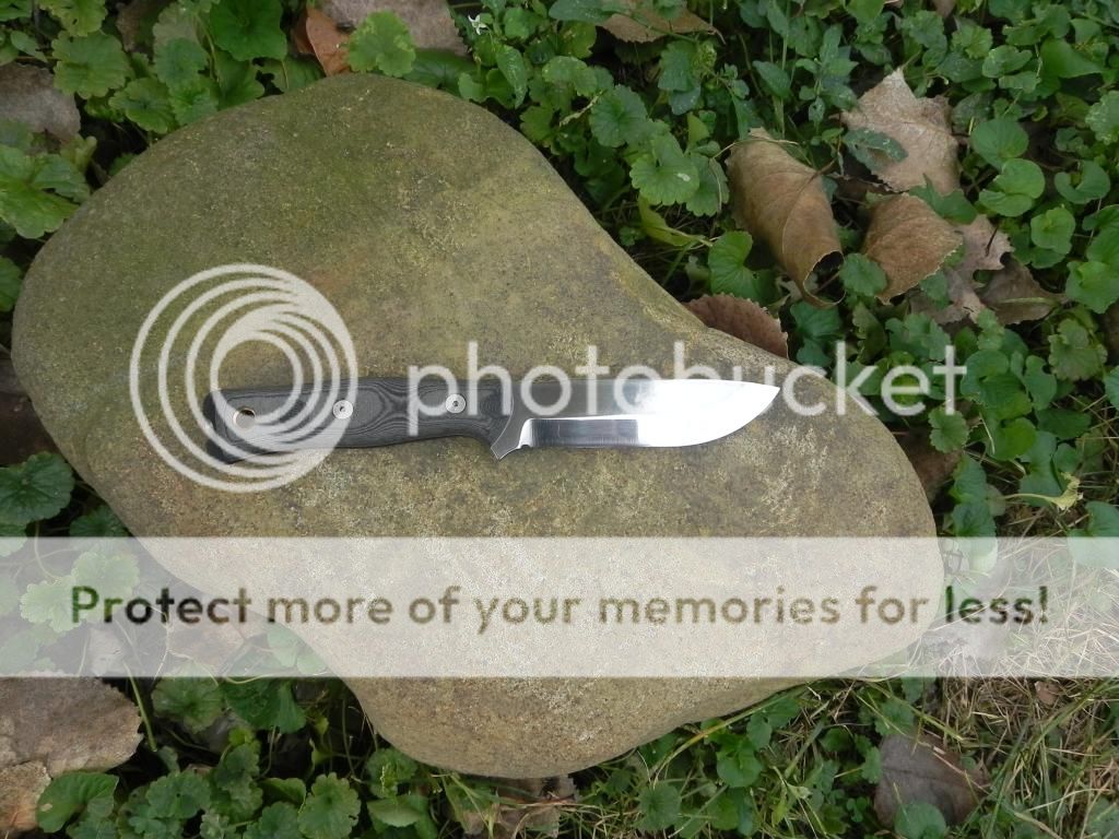

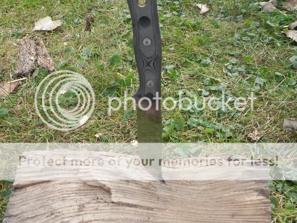

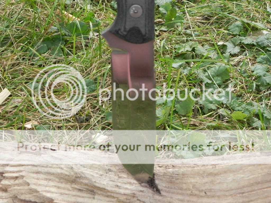

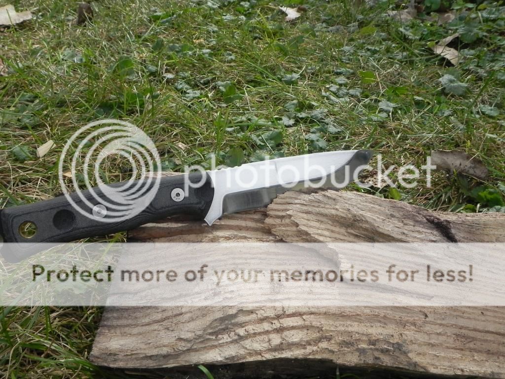

Hello everyone. I recently picked up a Tops BOB Fieldcraft knife with black micarta scales. I took it for a hike this weekend and put it through it's paces and was very very impressed with it. There were just two things I couldn't stand: 1) the overly aggressive jimping wore my thumb raw in about 3 seconds 2) the billboard plastered all over the side of the blade. Yesterdays Buckeye game was a blowout, so I decided to do some mods. I used a dremel to smooth the jimping down, stripped the coating on the blade, sanded it with 400/600/1200 (all I had on hand), and used a little green polishing compound. This is my first attempt ever at polishing something, I typically try to make things look old but figured I would try something different. I'm not sure how I feel about the shiny blade though; I am thinking about cutting up a bunch of red meat to try and get a purple/blue patina on it. Let me know what you think. This blade along with my Bahco Laplander and Victorinox SAK are going to be my go-to woods trio for the near future; the BOB replacing my BK9.
Just thought I would share some pics:
Stock image for reference courtesy of http://www.gpknives.com/images/tops/BROSBLM[large].jpg
After mods

I think it looks outstanding. Pretty much like an entirely new knife. Nice work. I have 2 high carbon knives but both are fully coated like yours was and all I do is clean them off and then give them a light wipe with some mineral oil. Is the process the same with a fully stripped blade like this or is the maintenance a bit more involved?
How does the kydex fit after the coating strip? Did you strip the coating under the scales? Sometimes that coating can be pretty thick. It sure is on ESEE.
It is the same, except extra care must be taken to ensure the entire stripped area is coated.
The kydex fit is slightly looser, but I believe that is due to grinding the jimping down. I left the coating on under the scales. I made the mistake of completely stripping a Becker Bk2 under the scales and it was a PIA to take the scales off and oil the tang, which did rust.
