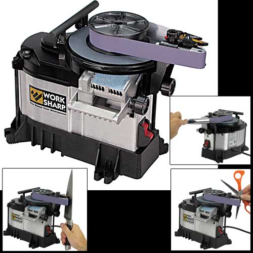

Honestly though, the power sharpener that I've seen that interests me most at this point is the Work Sharp woodworking tool sharpener. The 3k model with the metal casing, and upgraded internals looks seriously nice. Thick glass wheels with Norton abrasives, tool ports, "edge vision" wheel (which supposedly works really well), and the knife attachment...
The only problem is the price. It's not out of line, but I really want to go skydiving (of all things!) and can't afford everything I want. :( :p

Do you or anyone else have any experience with the Work Sharp 3k?
This is the 3k with the knife attachment.
