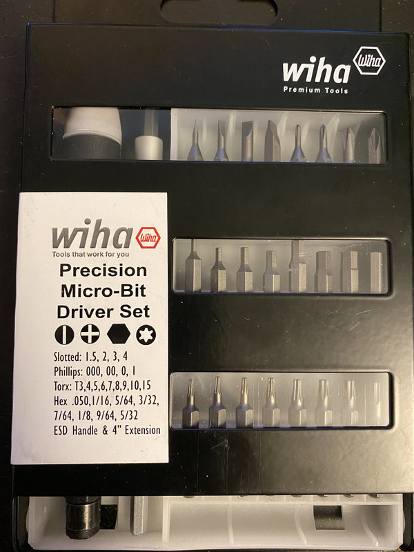

What torx tool should I get for taking apart my knives?
the boker wiha one seems good but it doesnt have a t-9 bit. other torx tools have other bits missing. What bits do I really (not) need?
do i really need something as small as t-4 or t-5?
thanks.

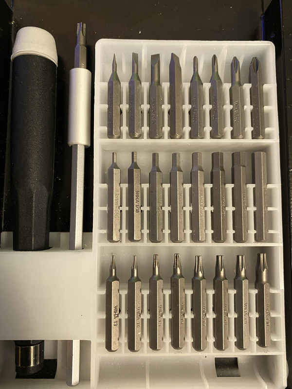

Another vote for wiha. If you already have a bit driver, can get the 71570 set that has 6 bits, T5 thru T10.
Wiha are high quality, that's mostly what I have, but you could get by with a set from your local hardware store. I used various cheaper brands of torx bits before buying Wiha and never had any problem (still use some of them). I switched to Wiha because I wanted to use a 1/4" driver and most of the bits I had were smaller. It's like the difference between a Snap-On wrench and a Husky brand wrench from Home Depot, the Husky will work just fine.
One benefit of Wiha is that you can purchase individual bits (and a driver). So you don't have to buy a bunch in a set that you don't need. And they have two different sizes- 1/4" drive, and smaller "micro" driver bits. I use both.
The sizes you need will depend on the sizes of screws in your knife/knives. Though I seriously doubt you will ever need a T4 or T5, those are REALLY small screws.
The largest torx driver I use on any of my production folders is T10, the smallest is T6.
