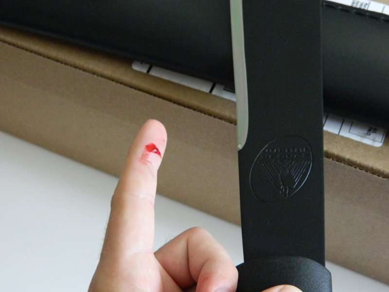

Just got my Condor El Salvador 18-inch machete in the mail!
VERY impressed!
Hard not to be! I cut myself within two minutes of opening it!!! :o
Everyone goes on and on about the sheaths. Well, now I know why. When they say "saddle leather," they really mean it. Smells just like a clean, new saddle. Take it from me, I own several. It's very supple and highly pleasing to the touch and eye. I sent the machete to my parents' house and my mother even commented on it.
Well, one thing they don't say about the sheath is that it's crazy tight. I'm sure it will loosen with time, but right now, it takes serious force to get the machete in and out. To do pull it out, I looped one finger over the mouth of the opening. You know what happened next! :D
Here's a picture of it beside its Chinese comrade in arms:
The Condor feels very substantial. It's noticeably heavier than the bent piece of pot metal it lies beside. It doesn't flop around when you wave it. :)
FortyTwoBlades wasn't exaggerating when he called the handle an ergonomic wonder. However, though I'm well built, I have tiny girly-man hands. So, you're real man's hands might find it a tight grip. Dunno.
