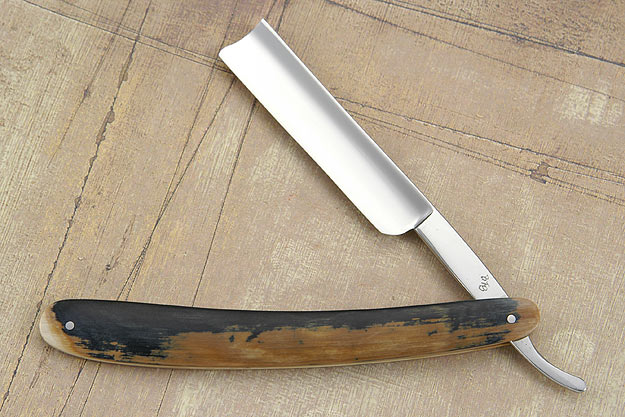

Here are a couple of pictures of the last straight razor that I made. What do you guys think?
Blade steel 52100
Blade length 3" cutting edge
blade thickness .130 at spine .007 behind cutting edge.
total length 9.70 inches
Nice piece.
But you should also give the blade width, it's always given for straight razors, most common being 5/8.

Sure does look sweet, man. I was just wondering though- is that .007" thickness directly behind the part that's sharpened, or is that measurement a little further back from the edge where it thickens a bit?
Seems like most of the antique straights I've played with were only about .001"-.002" or so behind the edge. The spey blade on my Case stockman is only about .005"-.006" at the edge bevel; I would expect a razor to be thinner...
I love everything about it Bill, nice to see modern craftsmanship put into a timeless classic

depends on the grind
extra hollow (singing blades ) are thinnest a bit behind the edge (there is a ridge )
i wedge grind can be more less ground to 0 before honing an edge on it and because of the way the grind ramps up would be thicker just behind the "edge"
its really how much time you want to spend on the honing of the blade
a true wedge (full flat ground ) would take a dang long time cause the whole flat is on the hone and needs ground
Very nice, Bill. Clean, elegant lines. I love the shoulder-less designs. :thumbup: How's it shave?

Very nice and clean with no drag or pulling. incedentally, of you guys that have or do shave with one of these, have you ever done a comparison of the old type of barber soap/shaving cream to out of the can shaving cream to gell shaving cream? For me the old kind that you mix up in a mug and apply with a badger hair brush seems to give a closer shave even with a modern razor. (gillet mach three).
