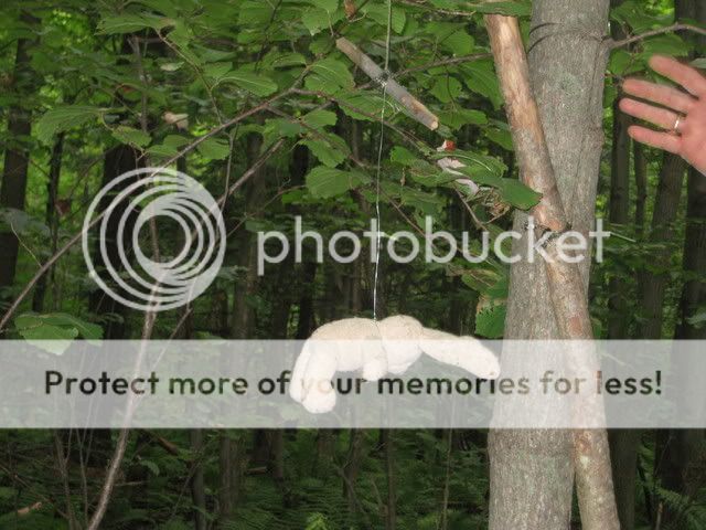

I'm interested in your favorite trap trigger. Whether you actually use it or not to catch food or kill humans doesn't matter, but I am interested in triggers that you have used and tried. Whether they be triggers by trip wire, for deadfalls, or snares. Post up a pic or sketch. Also, do you carry anything in your kit that doubles as a trigger?

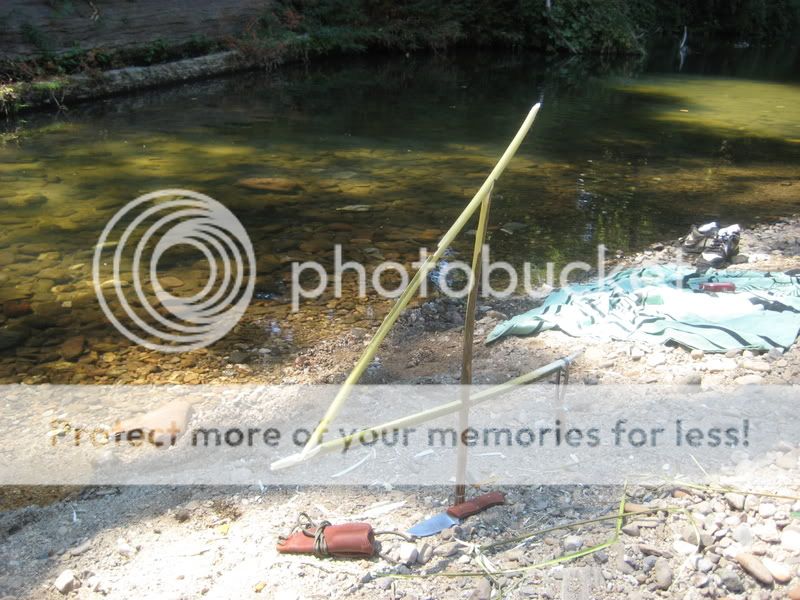

For years I carried rubber slingshot tubing for a twitch up style trigger. I may have some pics somewhere.
-RB
twitch up trap with rubber tubing.

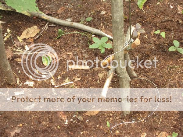

Favourite lifting pole trigger - nail trap trigger (courtesy of Ron Hood's video on trapping - highly recommended) This is one versatile trigger - it can be used vertically, right side up, upside down, horizontal, any which way at all:

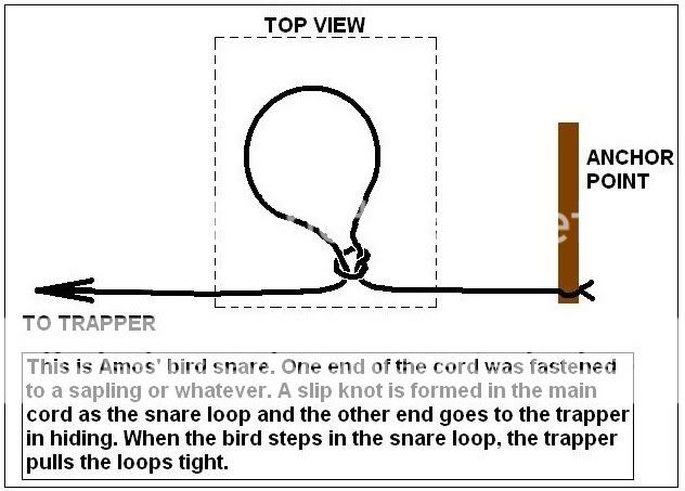

Favourite bird snare:

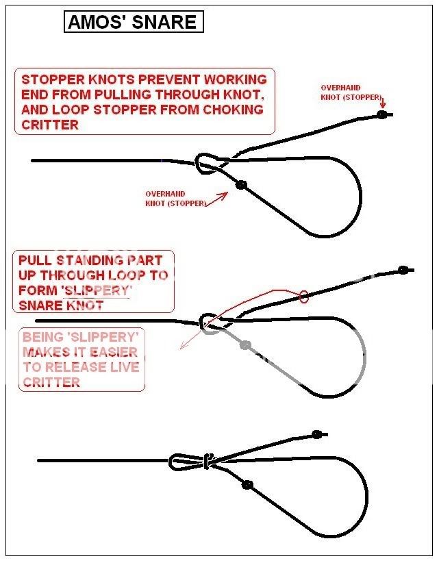

A guy I work with is here from Kenya. Here's a couple he uses:
In this first snare, it's basically a slip knot snare that is made slippery. I imagine this could be handy if you wanted to release a critter that you didn't want, and you wanted to keep your distance. He also employed a stopper knot because he didn't want to kill the animal (in hot weather, spoilage occurs very quickly). Alive, the meat is preserved. Also release can be effected if you happen to catch your neighbour's cat. :rolleyes:
I guess this snare explains itself:

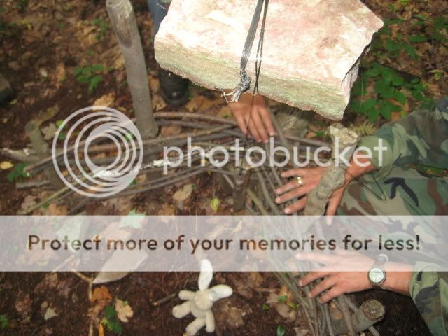

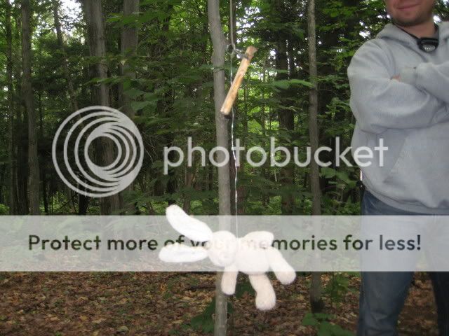

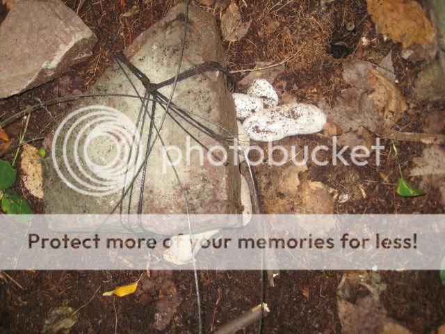

Here's a few I learned at the W.L.C. recently.
I was messing around at my cousins house a month or so ago with the figure 4 and gotta skunk that was nosing around in her garden. Wasn't a fun clean up:barf:
I like the twitch up on pic #5 down also.
Poor bunny

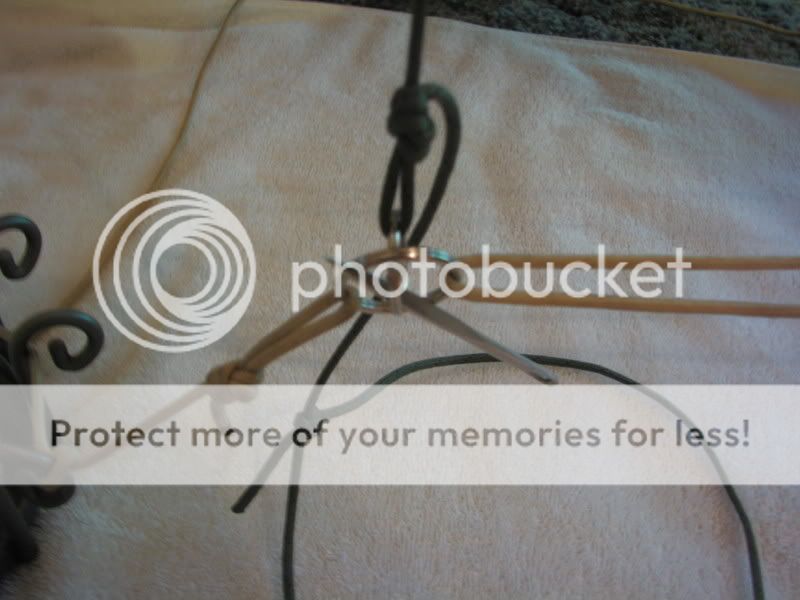

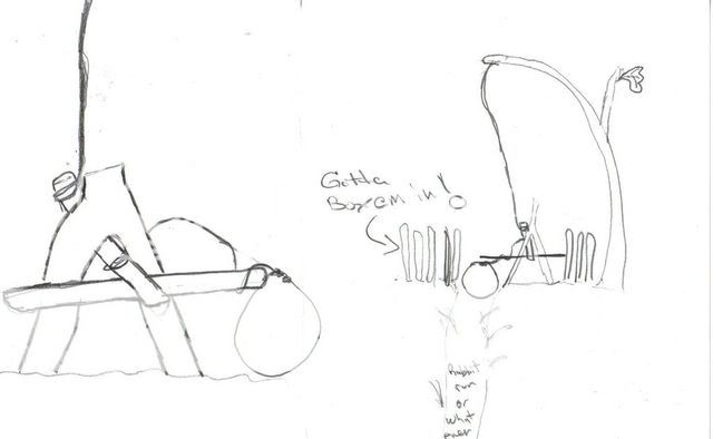

I have used this set up before, and it works well.

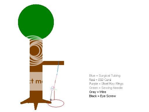

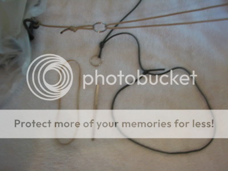

I wanted something that I could set up without using a knife, just what I would have in a small PSK like an Altoids tin.
All I need is a little wire, an eye screw, twine, a needle, and two steel key rings. A lot of gear has those key rings, and I wondered what I could use them for other than a what they were hanging off of. All of these have other uses as well as triggers for snares.
This is the set up I have come up with. It is very fast and easy to set up. I have bent a branch over, and used surgical tubing. Both work well.
Here is what I used. The white 550 you see is just for the picture. The wife would not let me screw an eye screw into her floor, so I had to improvise. Normally you would just have the screw with a short piece of wire attached to it and the key ring. The rubber band is the improvised branch bent over or surgical tubing. I did not feel like going outside to set this up on a tree.
Then set it up like this. It is very fast and easy to do with no knife needed at all. Bait the end of the needle and you are good to go. I would also tie the needle off with some thread as once this trips, the needle is gone forever. I have also used safety pins instead of key rings.
Here is a bad drawing, but I hope you get the idea.

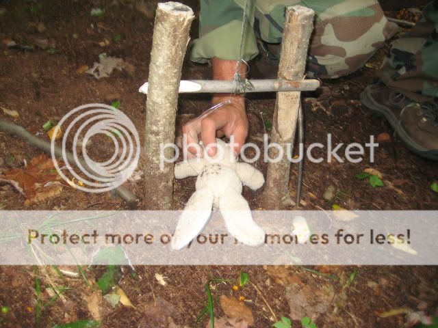

Here's a basic figure 4 trap, that mtnfolkmike made with the NWA knife and Izula when we met up.
i like the figure four. it can used with bait or if the horizonal trigger is set lower it can be used as a trip trigger. there are other triggers but i feel the figure four is the trigger to use when setting a heavy dead fall.
