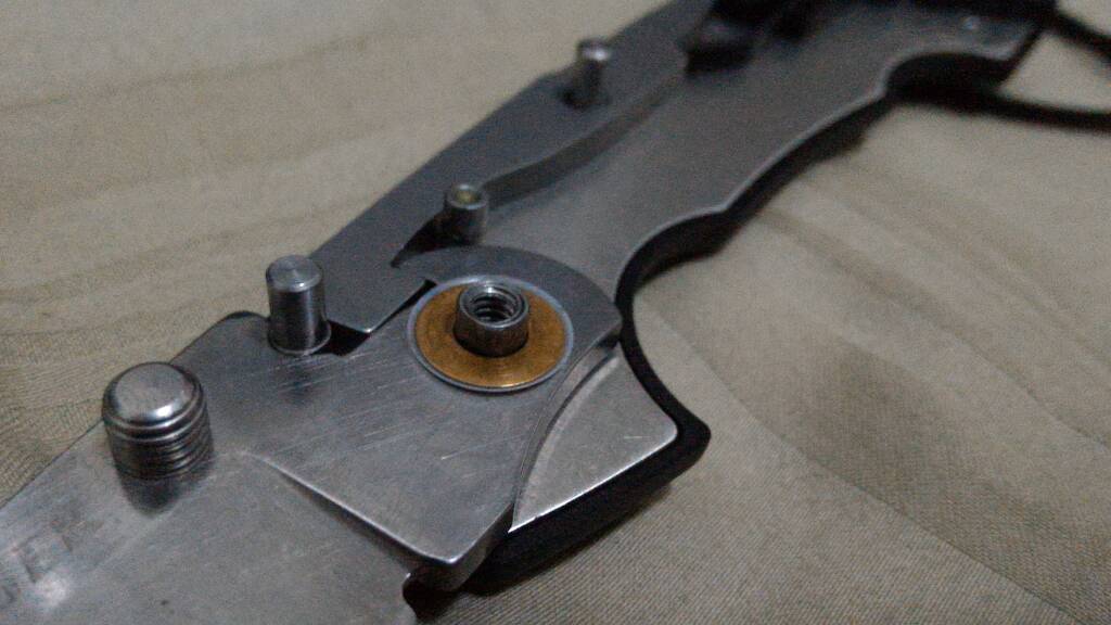

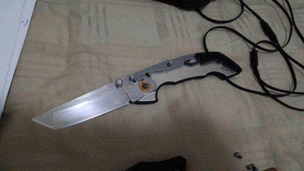

Hello everyone i have a problem with my CS Voyager med that has up and down play . Is it because the lock bar has sunk down?( i did abuse it somewhat) Are there anyway to fix this?

The lock bar is bottomed. This means the abuse has peened the locking surfaces and all the corrective adjustment has been used up. The lock will not fail, but you won't be able to get rid of the play without replacing parts. Rotating and locktiteing the stop pin might help. It would depend what parts are damaged the most. You could just keep it as a beater and get a brand new AUS8 version for 25-30 bucks.

When i wiggle the blade vertically there would be a that ticking noise (not that loud but not soft either)

It's just a tiny bit then, and I wouldn't worry about it. I have knives that cost many times as much that have more play.
Just curious, what's going on with the bronze washer over the Teflon washer? My Voyager had Teflon washers only.
Yes I ended up replacing the Teflon washers in mind with bronze washers but they only had single Teflon washers on each side
