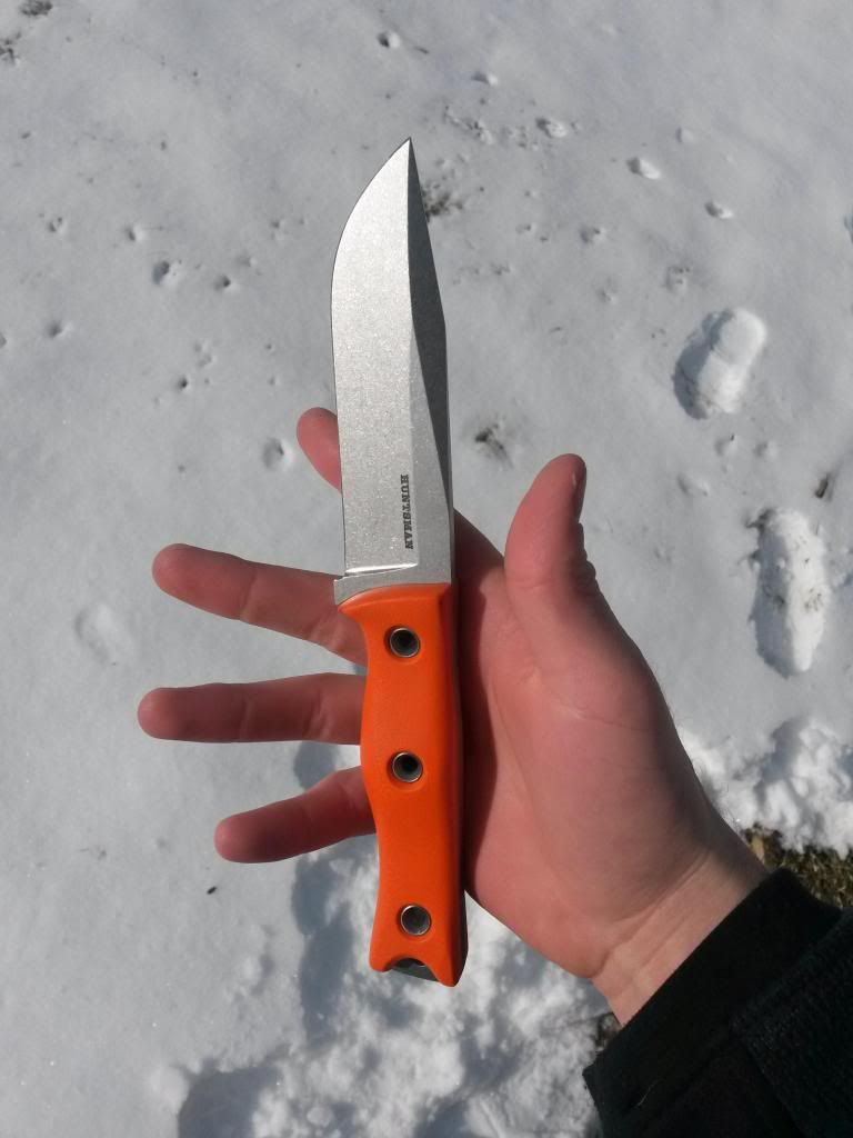

This is a tumbler finish I use a lot on hard users. I will take the piece to a polish, then tumble with ceramic triangles and WD-40. After that is a clean up, rub down with 0000 steel wool. Then an etch in diluted FeCl and again wipe clean. Then a dunk in black oxide chem and straight back in the tumbler. This is the wiped clean finish from that. (With the bevel touched to 400 on the belt...)
For simple C steel the finish seems to be plenty deep enough and close enough in color to the natural patina that it converts without ever looking blotchy. I have done this on several hard users and had it hold up well. Seems like it likes to hold oil pretty well. Of course this is done sans scales...
Oh, BTW its a larger RCBS vibratory tumbler. Will fit up to an 8"ish overall piece. I also use corn cob with polishing compound for a brighter finish without the elbow grease sometimes. I would love to have a larger tumbler or two, as especially in reloading they are indispensable.
I also use a mix of solvents and media for old tools. It's a recipe I got from an old tool collectors bible. Makes it nearly impossible to see my repairs most of the time. And gives them a uniform appearance the collectors have come to expect...
-Eric

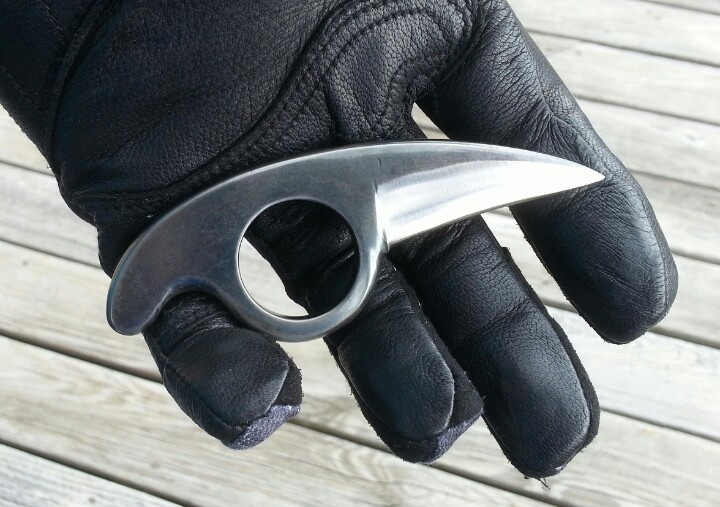

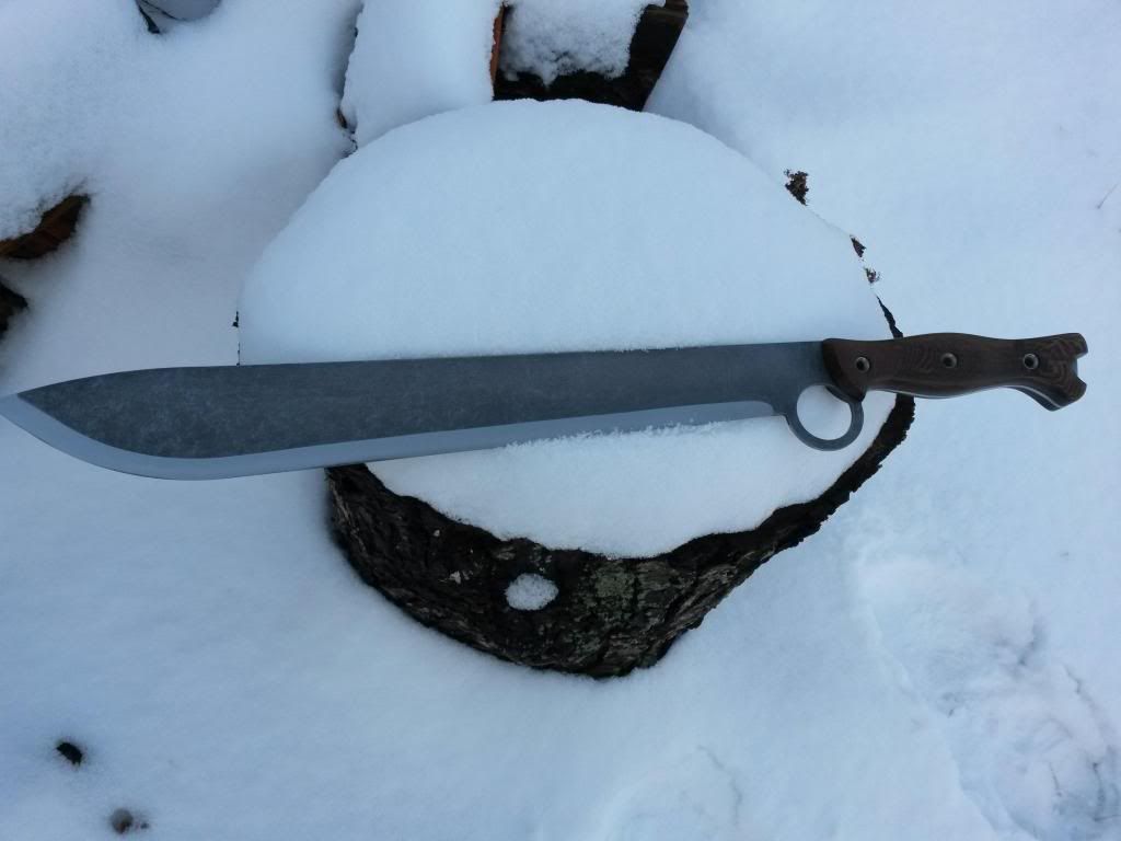

I usually do acid etched stone washed finishes on big blades. Here's two different styles that I use.
1.) Is a standard stonewash that is then etched. It looks about the same just darker. You have to finish the whole blade to 320 for this to work so I don't use it on machetes anymore.
2.) This is what I call a "heavy" stone wash with etch. For this method I attach bungee chords to the tumbler so it bounces vs. simply passing the material gently over the blade. This is a really nasty tough finish. The ceramic bits scratch a little differently and basically work more aggressively. For this technique I etch the blade and then tumble it afterwards.
Maybe this is the kind of finish you would get with a rotary tumbler? I'm not sure but its a great way to finish blades that you don't have time to give a good high grit belt finish first.

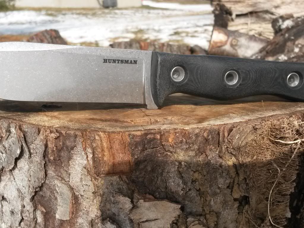

Aaron - this may not help you out much because you already have some tumblers but it could help someone. There is plenty of info on the web for going the cheap route and this is also great for someone just experimenting.
The blade below was taken to 400 grit then cleaned with acetone and then denatured alcohol. Dipped in a 50/50 FeCL and vinegar solution for five minutes. Sprayed and cleaned with windex and rubbed with 0000 steel wool. Repeat the acetone and alcohol cleaning and repeat the FeCL, etc. Put in a container with about 3 pounds of Harbor Freight ceramic media a handful of smallish smooth stones (for good measure) and WD-40. I used an empty rock salt container (I went through enough of them this winter) as it's tough plastic, large and has a handle. I let it dangle at the end of my arm and did a vigorous wrist twist for ten minutes. I think in this case I also cleaned it up, dipped it again and repeated the stonewashing. I love the finish (but not so much the handle on this one). I plan on giving it a lot of use in the next two weeks to see how it holds up. stonewash.jpgSW2.jpg
I do a quick 5-15 minute stonewash in a small HF vibratory tumbler with ceramic media and windex. I find the key is to keep the media clean, put it in a colander and clean with soap and water if it appears to be dirty.

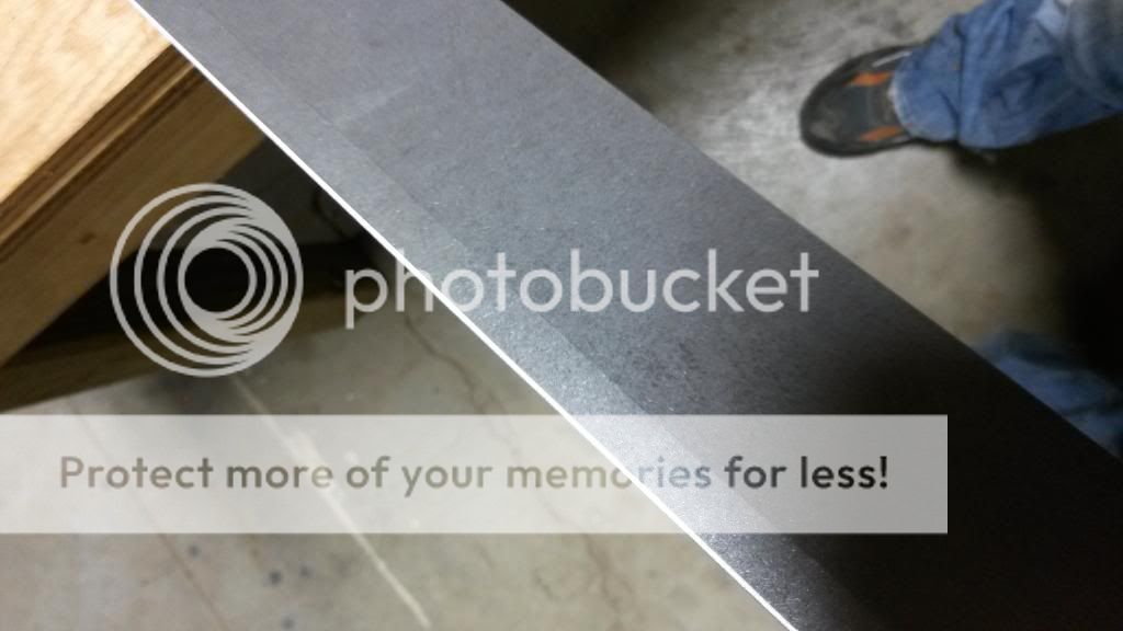

Here's a recent one done this way... maybe 20 minutes on the Titanium.
Dark pic but shows the bevel finish. I took the bevel to 600 grit and the flats to 220, blasted then tumbled. A quick acid etch will give the finish more contrast, this one was not etched.
