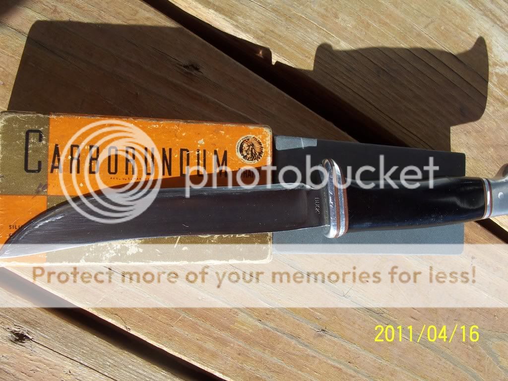

Hank, here is my stone from the same company. It's is an early one from 1962 a 2X4" and is much finer than Norton's JUM-3 fine side of 240 grit. It is more like 450 grit.Some folks don't think a arm hair shaving edge can be obtained from a 240 grit stone. DM
