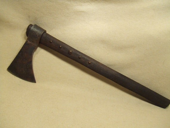

i think i might go with this one
"This camp tomahawk is tough and utilitarian. It has hand burnished hardwood for a long lasting, sturdy handle with brass tacks down each side. The head is hand forged steel, and it measures 4 x 6.25 inches. Total length of the whole piece is 19 inches.
It has been expertly 'antiqued' to achieve the look of a well preserved artifact. All materials are new"
That handle looks shot for new materials. I would buy one from a maker concerned about performance before looks. You may end up with a wall hanger made of mild steels overseas...instead of the User you want. I have handled the M48 -more of a weapon than chopper camp tool. Jmo
i still may not buy this one but i asked the maker if i can use it camping and he said yes. it only looks old. its a solid hickory handle and carbon steel blade . i agree it looks shot but that's why i contacted him. here is what he said
