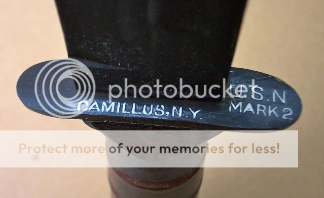

IMHO I still feel that this knife and the sheath are WW2 time period. After that I think this knife is “beyond my pay grade”.:distrust: I agree with Toooj I think I’d like to get Frank’s input on your knife. Regarding which of the four companies that made this knife I’m not sure. I am posting some pictures of a couple of Camillus made knives I have for comparison.
Here’s a late war guard marked Camillus/ USN MK 2,
You’ll notice that the Fuller on this example is more narrow than your example. But one of the things about the 1219C2 knives, (I’ve gotten into calling these that as it seems the most universal description), are the number of rather small variations in the knives even from the same manufacture. Here’s the same knife next to an earlier Camillus USN MK2 that is blade marked and the fuller is very different.
