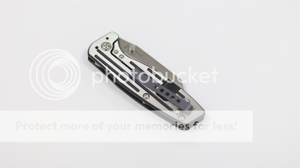

First is the Rogue(Ki3480):
1. Add chamfer relief to the finger notch to get access to the lock bar more easily.
Update version:
Previous version:
2.Use the same pocket clip on Escort and change clip position to tip up and tip down lockside.
3.Change flat grind to hollow grind.
4.Change blade profile. Remove concave radius on forward section of spine and make straight.
