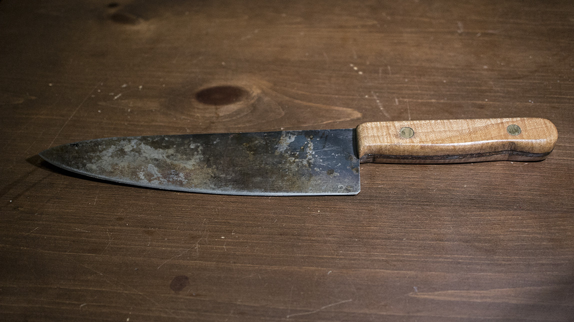

Using O1 steel and really like working it. But its very succeptable to rusting and I'd like to know more options to force a more uniform and longer lasting patina. Have tried vinegar baths and letting it oxegenate as well as soaking in water and letting it get all rusted then really cleaning it. All of these sort of work but aren't best. I was wondering if using a gun bluing fluid would work or if there are any other options im not aware of.
For reference, here is the first O1 knife with a 2 year patina:
And is a newer design with no patina:

There are different kinds of gun bluing-hot, cold, and rust bluing.
Of the 3, cold bluing (in a bottle) is useless. It provides no rust protection, stinks, and wears rapidly.
Hot bluing requires much equipment and is dangerous and expensive to do. It has better, but still very bad, wear characteristics.
Rust bluing is the most durable (still not good), and it takes time to do it-but it is easily done at home.
IMO- no bluing is a good blade coating.
Ionbond nitride coating holds up much better, but it is expensive.

Thanks very much for this insight. I'll look into Ionbond nitride coating. Appreciate the help!
Try Cerakote. It is very thin, baked at temps low enough that it should not effect your temper, and is very durable.
