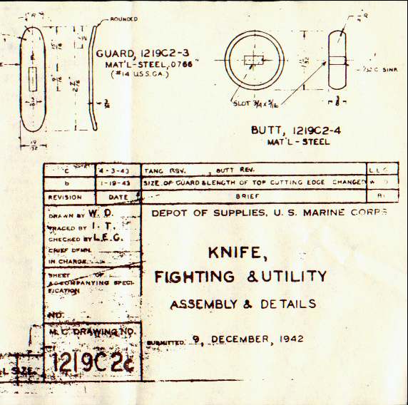

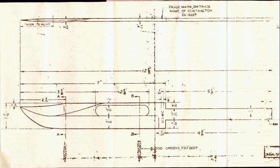

As for the Mark II "Ka-Bar" knife, it was originally a NAVY knife, intended to replace the less-than-satisfactory Mark I's. That's why they are designated "Mark II."
Camillus Cutlery made the first of them, using War Department drawings and specifications. Camillus discovered a flaw in the design -- when dropped just-so, the pommel broke off and rendered the knife useless. They made an interim correction and notified all the other manufacturers, who did likewise.
The USMC was also looking for a knife, liked the Mark II, and placed their own order with the same four manufacturers. The first shipment they received came from Ka-Bar, and the rest is history.
One can still find a few USN-marked Camillus Mark II's with the threaded nut holding the pommel to the tang, like this:
There are no USMC-marked Camillus Mark II's with the threaded pommel. In fact none can be found, with either marking, by any other makers. Instead, the first-generation pommels are peened and/or welded to the threaded section, like this first-generation Ka-Bar:
Later Mark II knives by all four manufacturers have the rectangular tangs, usually pinned to the pommels. That means the drawing, posted by T tltt , is for the second-generation.

T tltt - Thank you for the original drawings! Is there any chance that you could PM or repost the current USMC drawings? The links don't work for me (getting a 404 error).

You can right click the image to open in new tab, then you can further enlarge them by clicking again :).
Edit - links to the big images -
Knife -
1 https://postimg.cc/nMh1z9Zn
2 https://postimg.cc/SJTQh5dy
3 https://postimg.cc/bd12qzSq
4 https://postimg.cc/CZNFxxpf
5 https://postimg.cc/CBG6gz3W
6 https://postimg.cc/QFDC8PKw
Sheath -
1 https://postimg.cc/V5c0ML7h
2 https://postimg.cc/cg1RRxhw
3 https://postimg.cc/4nMmQ6QB
4 https://postimg.cc/KKz15Jwp
5 https://postimg.cc/qN9784cq
6 https://postimg.cc/pm1F4wfM
