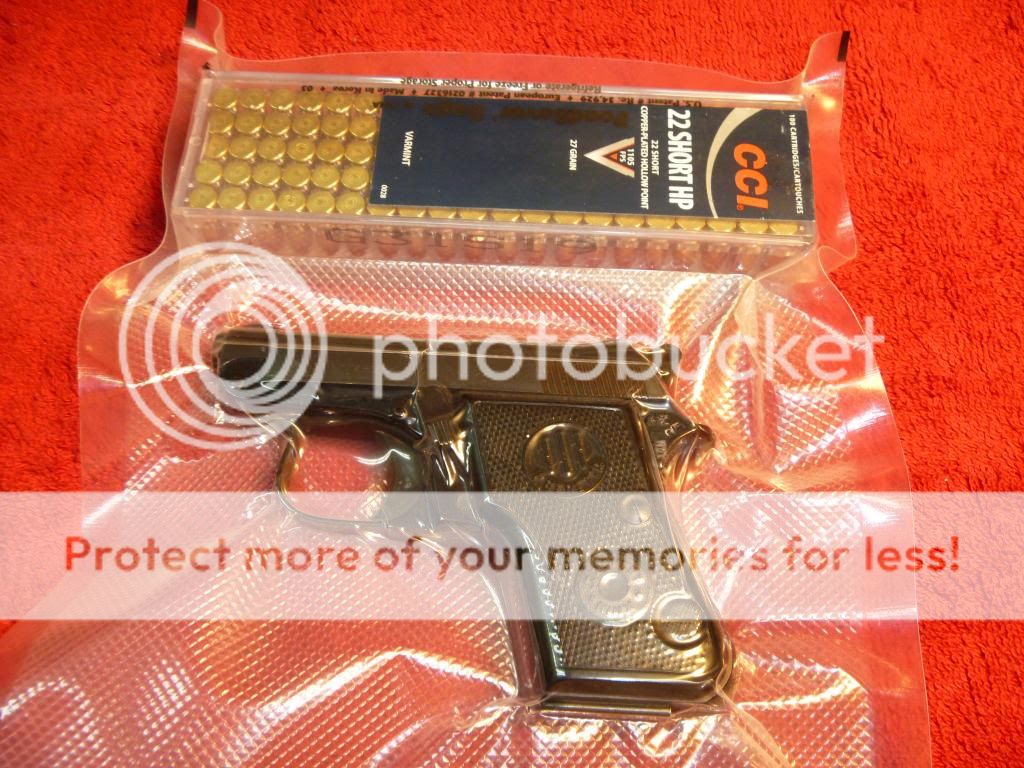

I know they do it for ammo... and they can still be viewed in clear vacuum bags.....

Wow, .22 short! Don't see that at the hardware store anymore.

Ps: one of my collectible guns is exactly this model. Nice!!!
