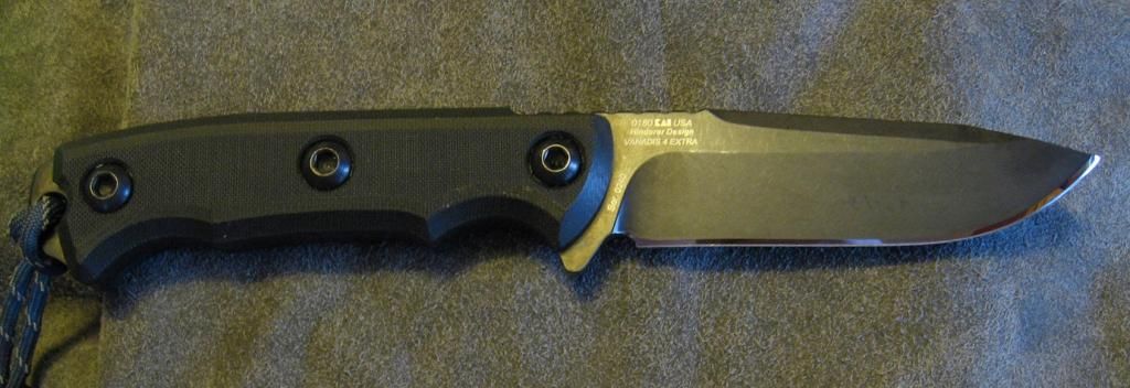

I have the ZT 0180. So far I am very impressed with the steel. I am not sure what they got the final hardness to in this run but...it took me a while on my Wicked edge using diamond stones to re-profile it. I sharpened it to 17dps and left it a little toothy by stopping at the 1000 stones. hht2 along the entire blade. Took it Elk hunting right after that and put it through its paces and let others use it. It holds an edge longer than my random leek sv30. It was used to process 4 elk and joint off the legs of them. So it hit bone and was twisted around in the joints. It suffered some damage at the very tip when someone was using it like an ice pick to get a joint to let go...was in the wrong spot...and the curved section of the belly. Just where you would expect damage with this kind of abuse. It was still shaving sharp at the majority of the flat portion of the blade. Even the damaged sections would only be noticed by someone with knife edge knowledge. It would still slice the crap outta rope. It held up very very well in my opinion. I would love to know the specifications to what they ended up on the hardness scale with this run. She is a keeper! It was never cleaned real well the entire trip and there was always contaminants in the sheath. So for say 6 days it was just wiped clean. No staining but when I got home I cleaned the crap out of it, resharpened it and oiled it for storage.
Zamfir, thanks. Nice post. Good to hear some feedback on real world use. The 0180 and its steel have had me interested.
I hope to give it some more abuse camping or something. Hunting is done for me for the year. Maybe I can hack some wood with it or something lol. When I resharpened it, I mirrored the 17dps bevel and then put on a 22dps mini bevel and left it toothy with a 1K diamond plate.
