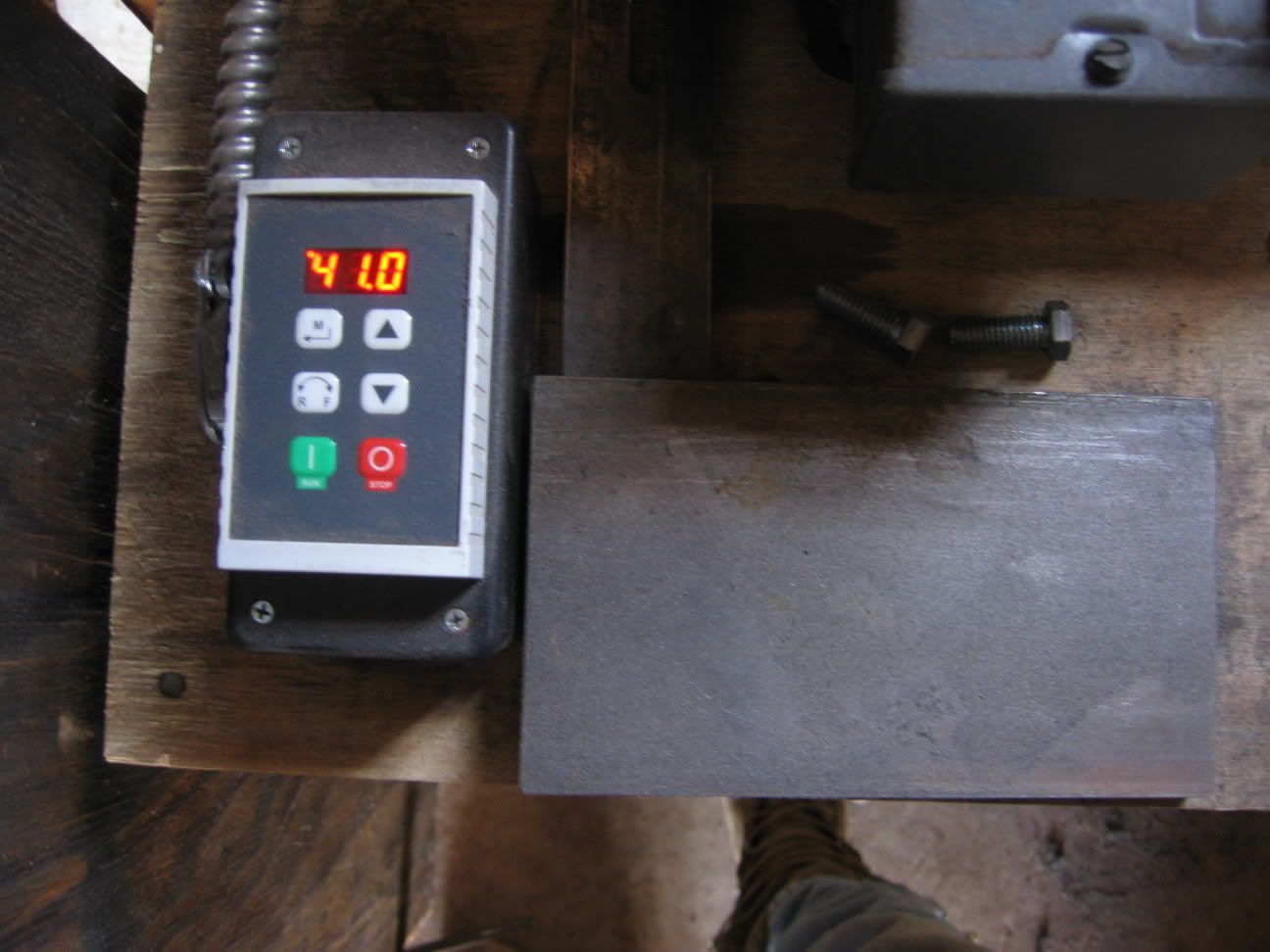

I picked up a NEMA 1 VFD off ebay and used a old ammo can to put it in. It included a remote key pad with it that controls the speed. So far it has run great with no problems and no dust that i can detect inside the can. I checked on the company's website about mounting it in an enclosure and the only stipulations were that it neede one inch on the sides and 2 inches of clearance on the top and bottom.
closed
open
key pad
rtj
The clearance specifications in the manual are to allow free air circulation for cooling the VFD. It assumes that the air will circulate into the room. The $500 box that John refers to would suck outside air in through a filter to provide fresh, cool air for the VFD. The heat generated by the VFD is carried away when the air leaves the box. I have heard of industrial applications where a VFD is mounted in a totally sealed box that is much larger than the VFD. The VFD's fan circulates the air inside the box. The heat generated by the VFD escapes through the large surface area of the box. This approach is tricky since it is difficult to calculate the heat flow through the walls of the box and testing is required. If your VFD is not tripping out on over-temperature after running at full load for extended periods, then your set-up has "passed the test". If it does trip out, then, use a larger box.
The one other area to check is the keypad. Not all are completely dustproof. You will have to check in your manual. Metal dust getting into the keypad will probably not cause a "big bang" but will likely cause some sort of erratic malfunction that will drive you crazy over time. A simple improvement would be to wrap the keypad in a thick plastic bag. Also, the opening for the wires from the VFD should be sealed up with some caulking.
By the way, what brand/model of VFD did you get?
Phil
The brand is ac tech SM230S, its the 3hp model. I got everything with shipping for $300. The keypad appeared to be a totaly sealled unit, there is a gasket on the back and i used one of those project boxes from radio shack to mount it on. I was concerned with the heat build up inside the box and for the first couple times i used it would open the ammo can to feel if the inverter was getting hot. So far its run like a champ. If this summer it starts getting too hot i was considering getting drilling a hole through the back and putting a dryer vent over it on the outside. I am no expert on this stuff so if anyone can see any potential problems please let me know. Thanks
rtj
