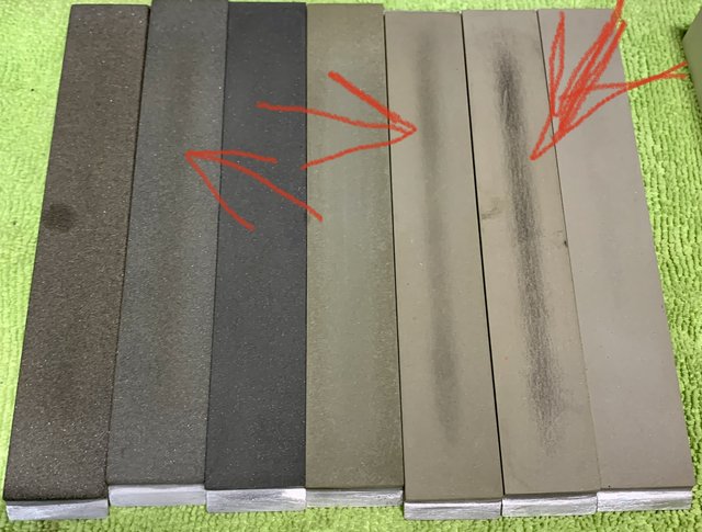

Hello, Newbie here. So I apologize in advanced for my ignorance.
1. I purchased a set of the Venev Orion Stones and was wondering if the caliber measurements I took on them shown below is with in range of new stones ( I have sharpened 3 knives and cleaned them with a 8000 grit Nagura)? You will notice the F800 are less a bit thinner than the others. I'm sure I'm just being anal as always, but would just like to confirm from y'alls knowledge.
And, are they within an acceptable flatness range, some are off by a few tenths of a mm.
2. Will cleaning these stones with the Nagura wear the stones or is it so slight it is ok to clean with Nagura after each use, and how many knives will these stones sharpen before needing to be replaced? Also, what is the preferred method of cleaning these stones?

Your measurements seem to be within the normal range for these stones. You probably already do this, but I would suggest to always check and adjust the angle every time you swap any sharpening stone, it's a good habit to get into. I'm assuming you use a fixed angle sharpening system. Even if some stones are exactly the same when new, any resin / binder based stones will wear out differently (especially the coarse ones), so invariably they will all be slightly different.
You are correct in assuming that using your Nagura on them will very slightly abrade the bond of the Venev stones (and other bonded stones), but definitely not excessively. There is no real need to do it every single time you sharpen, you can generally just clean them with a nylon brush, dish soap and water after sharpening. When they start to load up a lot, then use the Nagura to clean & condition them. They will be slightly more aggressive again when freshly cleaned with your Nagura(especially the fine grit ones), but they settle in again quickly after 50 or so strokes.

So here is a picture of my stones after just one sharpening and washed with dawn dish soap, water, and toothbrush. Do these look clean enough or should I be trying to remove the black streak on the F800 and F1200 stones? if so, that would require the Nagura stone or maybe I should try some Bar Keepers Friend.
That little bit of swarf won't have any real effect on your sharpening. It looks bad visually, but the diamonds still protrude through the swarf until it's very heavily loaded. I would say there is no real need to remove it just yet.
Bar keepers friend will clean up most of it, and also remove a tiny bit of bond but will not be an issue. A Nagura will maybe remove ever so slightly more of the bond than Bar keepers friend, but still very little.
If the swarf bugs you, then by all means use Bar keepers friend or your Nagura. It doesn't do any damage. (I know sometimes I also just like to store my stones clean when I know I'm not gonna use them for a while)

Yes, it's absolutely fine for quite a number of sessions. Once you get used to the stones, you'll feel when they don't cut as well as they should.
