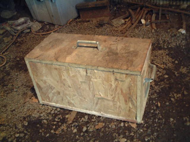

I've always found lime to be a much better insulator.

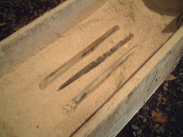

I now use my heat treat oven, but I used to keep an outfit like shown here. I would heat up two large pieces of steel and bury them in the lime a few inches apart to heat up the lime and add extra heat.
The longer you can keep the new blade hot the better the action you get.
Then heat up the new blade and place between them and cover with a few inches of lime.
I once went out to my barn where I used to forge about an hour after I placed a blade in and when I uncovered it, it was still glowing red in the dark!
