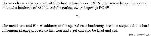

Does anybody know how hard they make their files on the swisstools? I'm trying to figure out what I can expect from mine, but it seems they wear out quick for a lot of people on the SAK's.

There's information (originated from Victorinox) in this pdf document at pizzini.at (an Austrian SAK vendor) worth downloading -
Victorinox Info (pdf)
Here's the relevant crop from that document -
