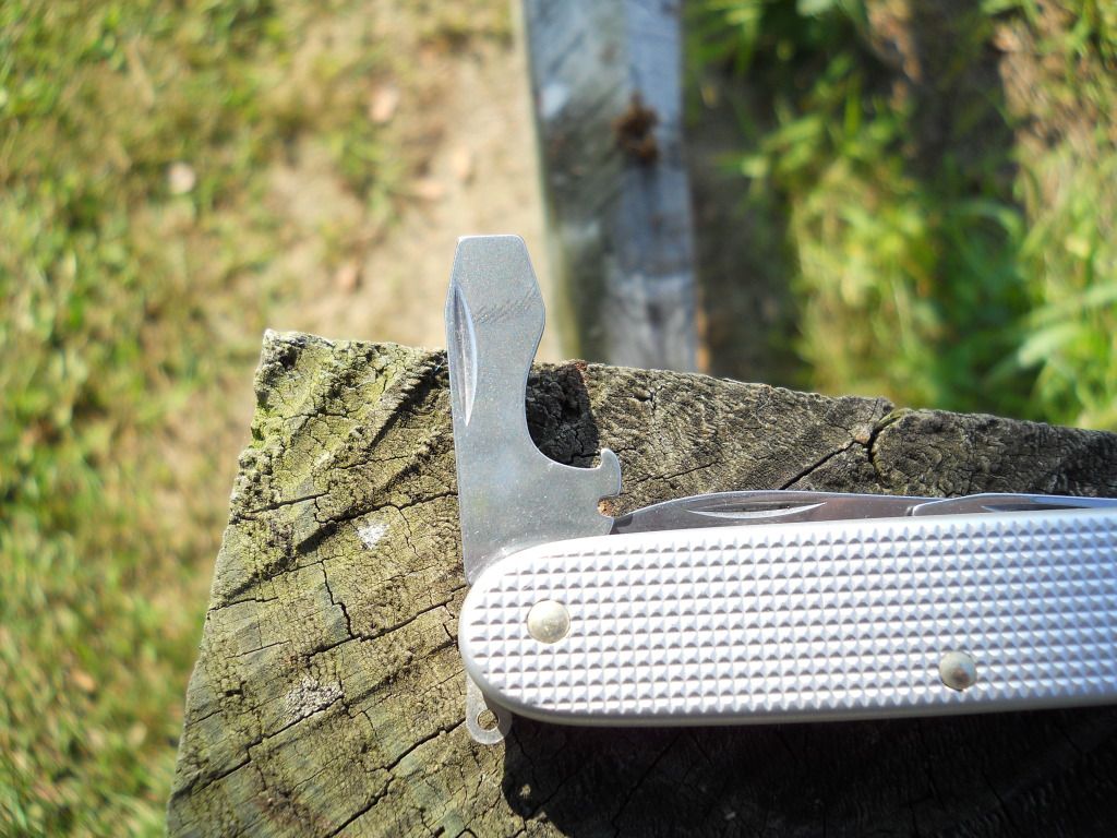

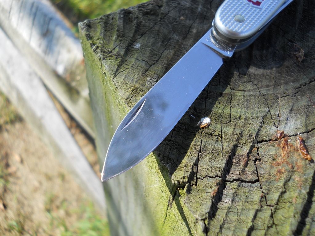

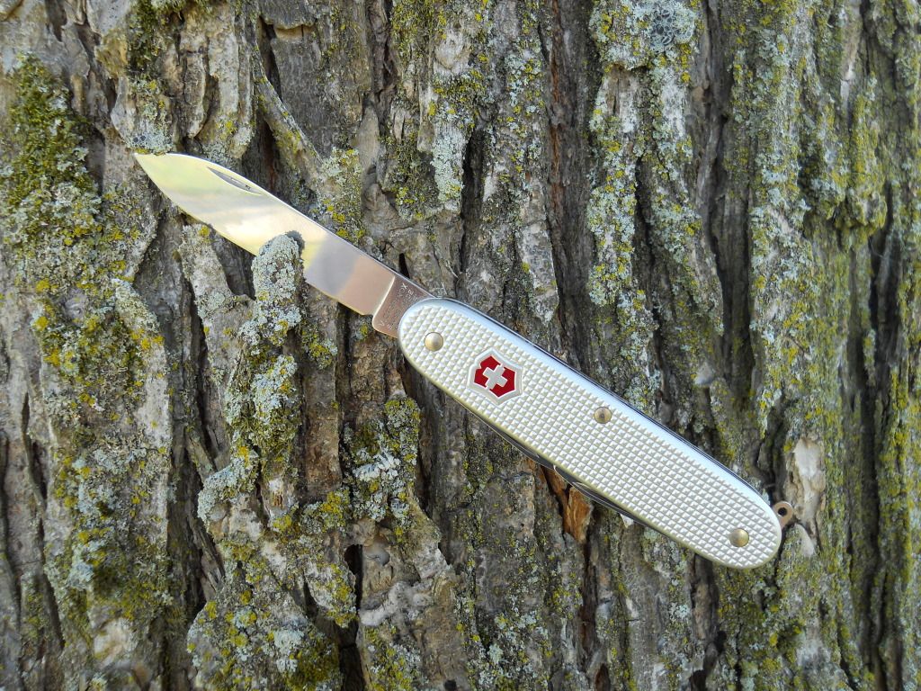

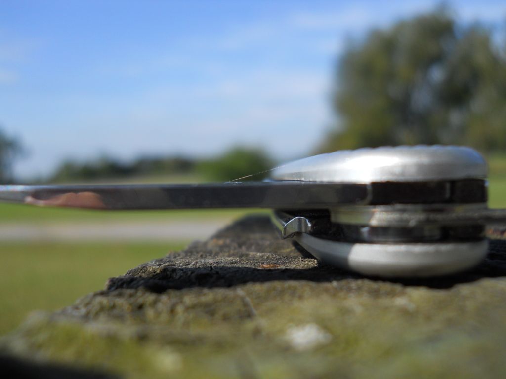

Pictures:

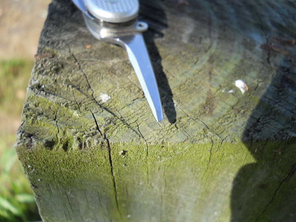

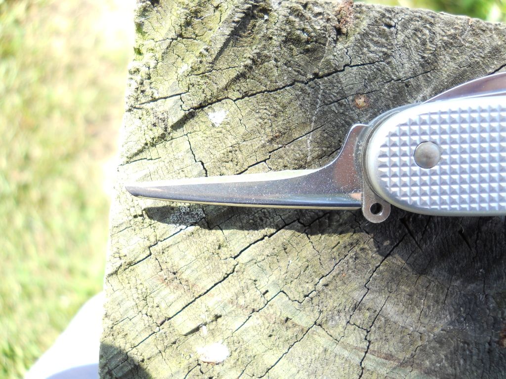

No problem :) and whats the tool in picture 4 called? what is it used for? because i have no idea.
It's called a reamer, or an awl.
It's basically a drill.
The tip is curved slightly so it digs in.
You use it by pushing the tip into something relatively soft, like wood or plastic, and then start twisting while keeping pressure pushing.
The farther in it goes, the bigger the hole gets. The edge is chisel ground so every time you twist, it cuts the hole bigger and deeper.
