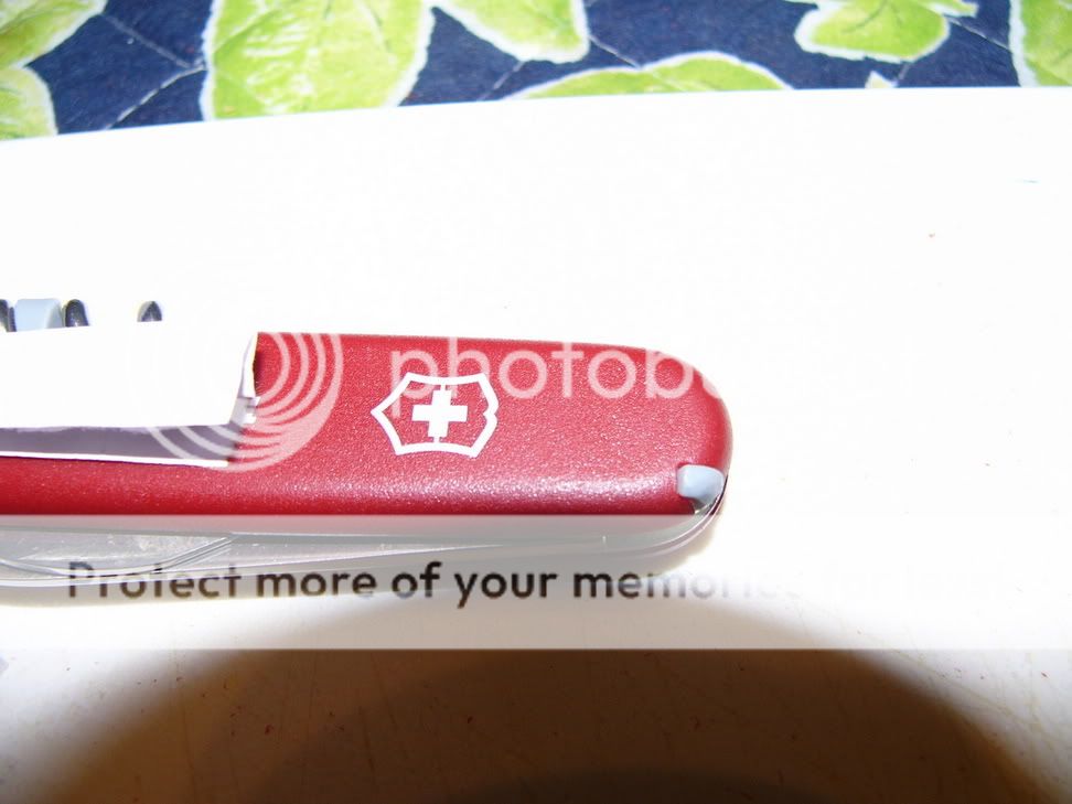

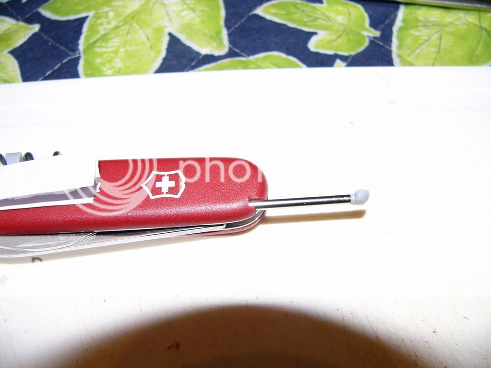

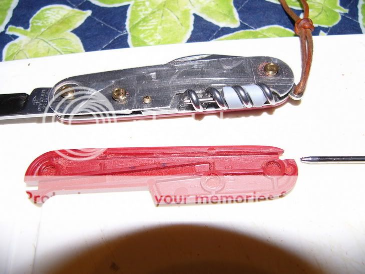

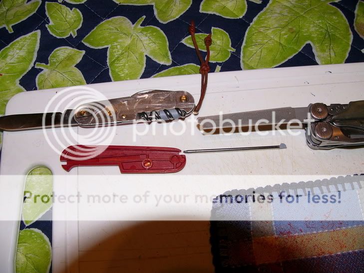

ok, today is not manday but here are my pics.
The process was easier than I expected.
To take out scales put a blade under scales and try to pry to pop out from rivets.
After I used my wave file (excact wide ;) )and made space to put ballpen take care no wearthe scale it no much material in it, so hand work and many tries to check the deep of channel you are grinding with your file.
At the end press the slaves in again and it´ll fix with no problem.
Avoid to refit scales may times becouse the pin location would wear and the no enough fricciton for permanent fix.

Hi UnknowVT.
Yes you can fit the ballpen in as you say, there is same space to rivets but my reason to do the way I show is because I use to caary my Vic in my watch pocket vertical with keyring ot lanyard up for easy deployment, in tis way the ballpen is ball up so you avoid the squir ink in case it occures during the daily use.
