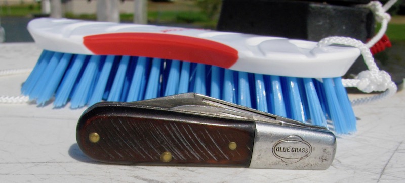

Popular "INEXPENSIVE" (not "cheap" -- there is a difference) Shell Construction/Hollow Bolster Barlows were made by Imperial, Colonial, and post 1933-ish Hammer Brand.
They all had/have the same high quality and properly heat treated 1095 blades as their more expenive contemporary counterparts.
They are still available for a "reasonable" cost.
To tell if a knife has shell construction/hollow bolsters is easy at a glance, if you know what to look for:
Hollow Bolster/Shell construction NEVER have a visible center pin, real OR FAKE.
Fake cover pins and bolsters? Yep. They are common.
The larger center pin about mid-length, nearest the bottom of the covers?
NEVER, regardless of brand and pattern.
