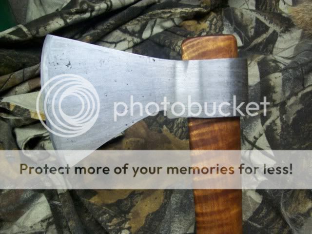

For tonight Ill post a pic or two of a standard "Wrap & Weld" hawk so you can see what we are after..
This one was Wrought Iron and high carbon cutting bit..
This one was 1018 mild steel and high carbon cutting bit..
Any questions just let me know..
