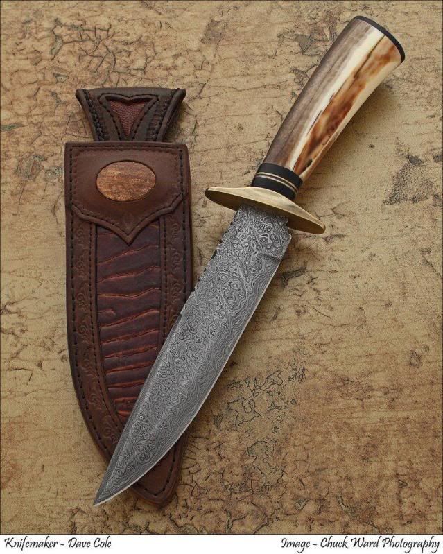

Actually, I find it not much different than sambar stag as its pretty hard.I just drilled it with a slower speed and slow feed. pull back to clean your bit often.Dave
This is one I just finished with Walrus Ivory

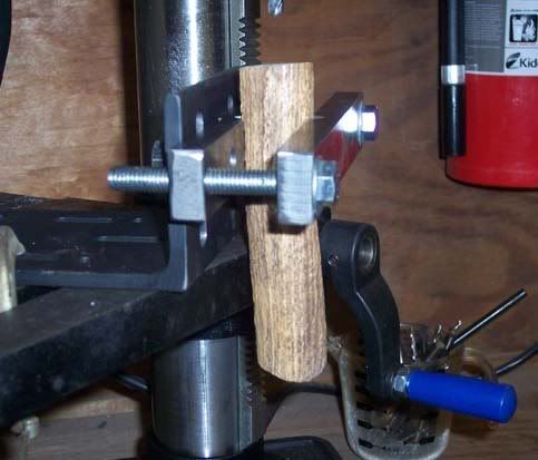

sounds good to me then! I did some google reading and alot were saying how brittle ivory was to work with and got me a little concerned about wrecking it...how do you grip it when drilling to stop it moving or twisting? what about drill sharpening, do you use a standard 118 degrees? or do you adjust the angle?
