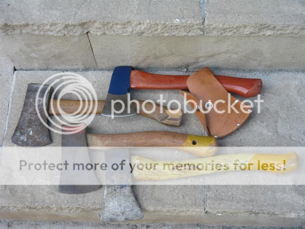

Now we're discovering what happened to the old Walters axes; they 'skipped town' for warmer/sunnier climates! You're finding more Walters goods in Spain than seekers of old tools are in Hull, Quebec (now called City of Gatineau) where they were made. You probably have a small hatchet there (I think they were called 'midgets') and a standard one. The 'midget' has seen much more use (toe is disproportionately worn) than the other one which is essentially unscathed.
Below are most of the ones (hatchets) that I gathered up over the years.

A nice selection you've got there, thanks for posting.
