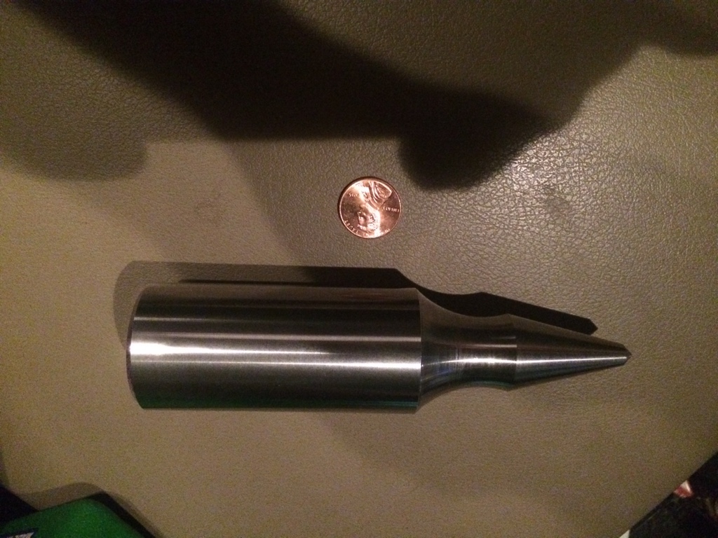

So, I think this is the best place to ask this since what I'm making is very similar to a hawk.
Anyways, I'm in the process of making a war hammer. I work in a machine shop and had a piece of 17-4 H1150 stainless round stock that I scrapped a part in school out of. I'm making the hammer out of it.
I'm not finished with the hammer yet, but I am looking for a shaft for the handle. Because of the equipment I have available I will be making this with a haft that will need a wedge to hold the head on.
I know I want 1" diameter. Beyond that, I could use some material recommendations. How the material looks is irrelevant as it will be wrapped in leather when everything is finished.
Oh, and pictures because people will ask lol. First is a CAD rendering of what it will look like. The second is what I've got turned on the lathe so far with a penny for size reference. It is going to be bead blasted when finished then the flats will be polished.
A stainless pommel is also in the works, but I'm not for sure I'll be making that.

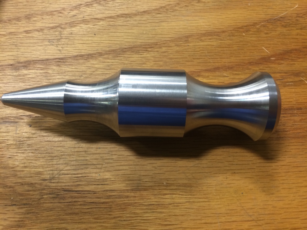

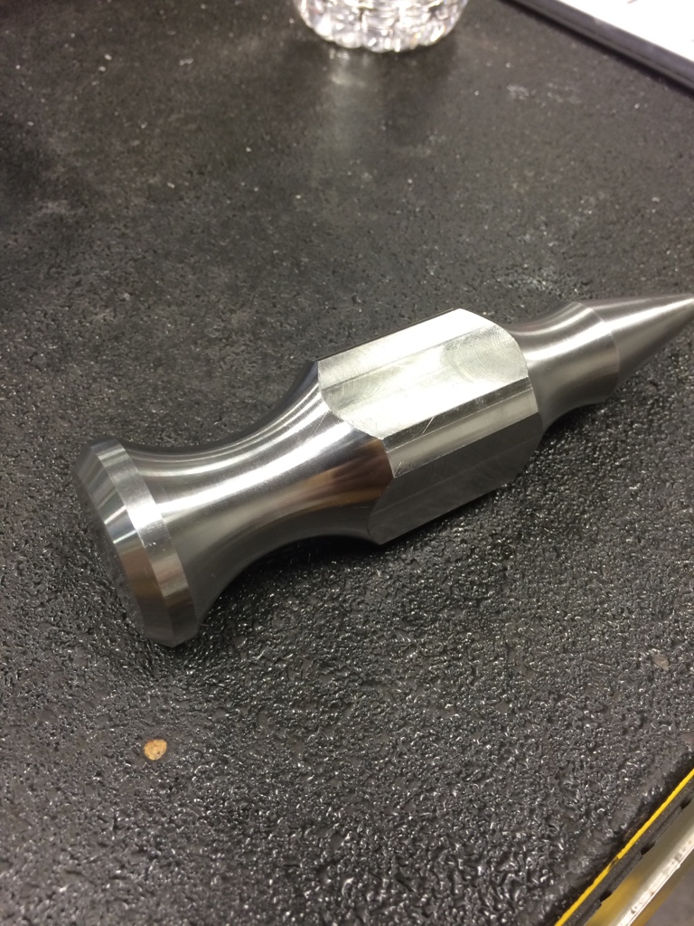

I've turned the other side of the hammer.
I have also decided to make a haft out of 1" diameter 7075 aluminum 16" long. I'm going to turn the 6" closest to the head to 3/4" and knurl the last 10 inches with either a medium or fine knurl. The end of the haft will have a 1.25" stainless ball on the end of it.
The head will be drilled and tapped and the handle threaded. They will then loctited together with red loctite.
I'll have the handle anodized either black or a very dark red

How did you decide on the angle of the cone section? It looks like a good compromise between penetration capability and not getting stuck.
Honestly, I had a piece of stock that had been partially turned down (1.5" stock) and made the spike fit in the turned down part. Altered one small thing in inventor and had my model, so it was kind of a fluke
