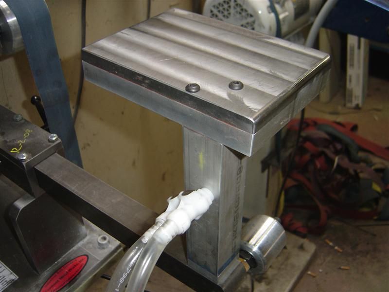

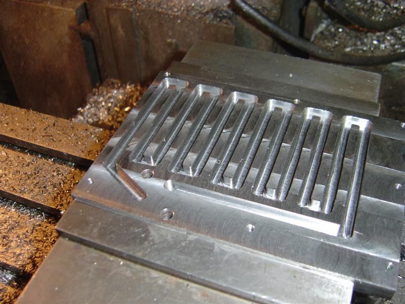

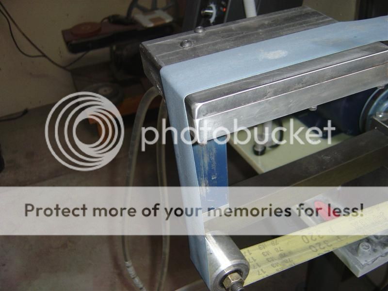

Joe has planted the seed of a closed loop water cooled platen into my head. I have plans for an aluminum attachment that would attach to the back of a regular platen that would have internal water channels like you'd do on an injection mold. Add a little pump, some ice water and your platen would be chilled. I was already thinking about something similar for chilled quench plates.
Guys, my shop is backed up pretty bad right now, but as soon as things slow down a little there are a number of very workable projects I'd like to tackle here.
...or get some cascade tubes from DME like I plan on doing for the next rev, and the Bybees have done already.
Something like this?
