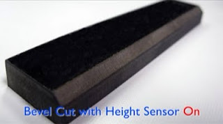

Take a look at some of the 5-axis water jet stuff:
http://www.thefabricator.com/article/waterjetcutting/2-d--3-d--5-axis-waterjet-cutting
http://blog.wardjet.com/2011/05/video-5-axis-bevel-cutting-with-height.html
http://www.wardjet.com/applications.html
With recent advances in control and motion technology, 5-axis water jet cutting (abrasive and pure) has become a reality. Where the normal axes on a water jet are named X (back/forth), Y(left/right) and Z (up/down), a 5-axis system will typically add an A axis (angle from perpendicular) and C axes (rotation around the Z-axis). Depending on the cutting head, the maximum cutting angle for the A axis can be anywhere from 55, 60, or in some cases even 90 degrees from vertical. As such, 5-axis cutting opens up a wide range of applications that can be machined on a water jet cutting machine.
http://en.wikipedia.org/wiki/Water_jet_cutter
By using this, you could program extremely complex (Or just precise.) bevels and shapes, and basically get a finished knife out of a single model in CAD.
