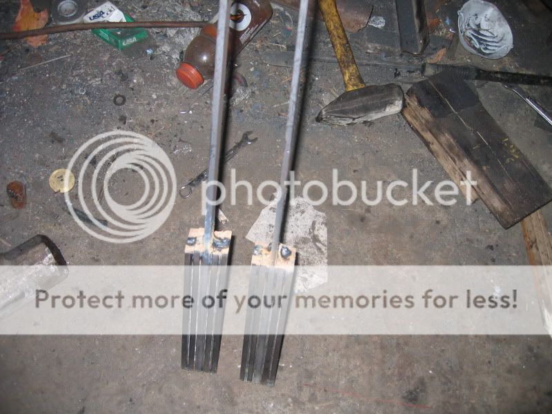

Does anyone have a recommendation for a welder that will be used for welding a rod to hold work piece when making damascus billets? What type of weld will hold up to the heat?:confused:
Personally I just use the center bar as the handle by leaving it the full length. I've tried welding re-bar handles on but I've found them to just be a pain since re-bar typically is junk that doesn't weld well.
Using this method I've had success with a tiny craftsman glassless mig welder but I've upgraded to a 295amp stick welder now.
Here is a picture of what I'm describing.
I use a little mig welder. for attaching the handle I grind a point onto the handle so the weld is full penetration
