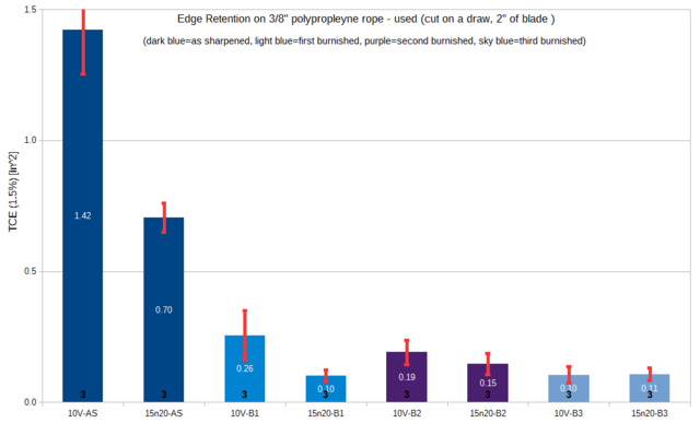

Hi,
Well,
I linked one source (thats easy to source),
it has this picture,
with each subsequent rubbing/burnishing/realignment,
the retention drops , edge goes dull quicker than fresh
If you visit sites like cheftalks/kitchenknifeforums,
you can find similar reports from cooks/chefs,
they talk about how they can keep a knife sharp enough for food
for a long time burnishing/steeling/realigning, up to six months,
at which point it no longer works
The explanation is metal fatigue,
like bending a wire or paper clip back and forth,
at first its hard to bend past the yield point
but it gets easier and easier ,
wire turns floppy like rope,
and then the wire breaks
The very cutting edge, the apex on a knife is about 1 micron wide,
its like a 1 micron wire ,
its very easy to bend as its so tiny
1 micron is 1/1000th of a millimeter,
printer paper is 100 micron thick,
average beard hair is a little thicker around 120
So thats where the conclusion comes from,
from basic engineering principles,
easily confirmed with a paper clip
Also important to note is
the damage extends beyond/below the bend point,
the metal is being cold worked
and it can produce spectacular results ;)
as can be seen in this video Issues sharpening a heavily abused knife - Yanagi-ba - Cliff Stamp whose thread has pics

I'll also add my 2 cents on the effect of burnishing, even though it applies very little to this conversation IMHO - the effect of sharpening on glazed abrasives and plastic deformation on a smooth steel are going to be very different.
The effect of local work hardening with a smooth steel generally improves the surface "microhardness" and will theoretically/anecdotally lead to an increase in edge retention in steels that are not fully hardened. It will also draw out the edge, so if the rate of burnishing exceeds the rate of wear you'll have edge failure. If the rate of wear exceeds the degree to which the steel can be drawn, the edge won't get sharp. At some point even if these two factors are perfectly managed the region of the edge will have worn back and been drawn repeatedly out to where it is out of reach of further plastic deformation to restore the edge, at least at any effective angle. This is best case failure but you'd be hard pressed to achieve it due to the difficulty in burnishing with precision combined with uneven edge wear. In most cases the edge is overdrawn and fails in use like any wire edge.
It is used commonly in machining for final finish work to tight tolerances to improve surface hardness, in the form of roller burnishing. It used to be only used on unhardened steel and steels HT'd to low values, but it is currently used on steels up to low 60s RC to improve surface wear. There are obviously application differences between roller and ball burnishing and those in play either intentionally or deliberately when it comes to sharpening, but the poison is in the dose in this case.
