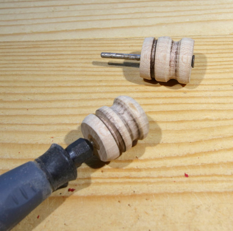

Made these burnishing tools (broomstick, nails, superglue):
