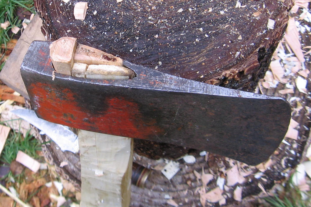

Square_peg Basque axe pattern was settled very long ago, at least my grandfather told us he allways knew it as we know today. This type of axe has a slip fit eye, I have never heard nobody concerning about its poll absence neither about lack of balance. They are the standart working axes here, Basque racing axers use internationally standard pattern ones in their competitions, but at home they use traditional ones.
Those axes don't have any eye issues doing any type of cutting. I'll post two photos of 2.5kg Basque axes, I have already posted one of them, but I think it needs to be reposted to show the eye.

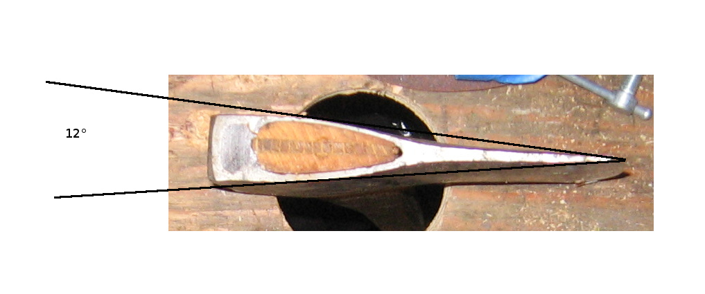

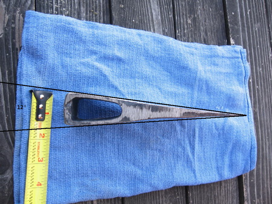

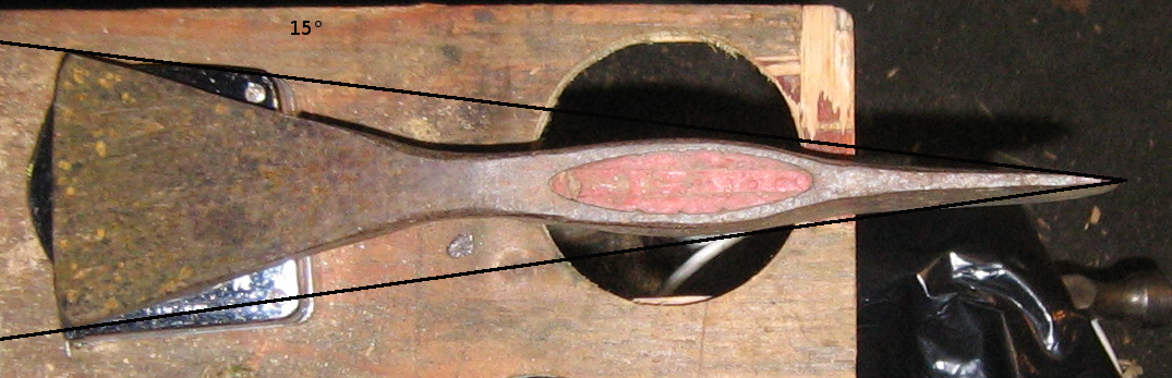

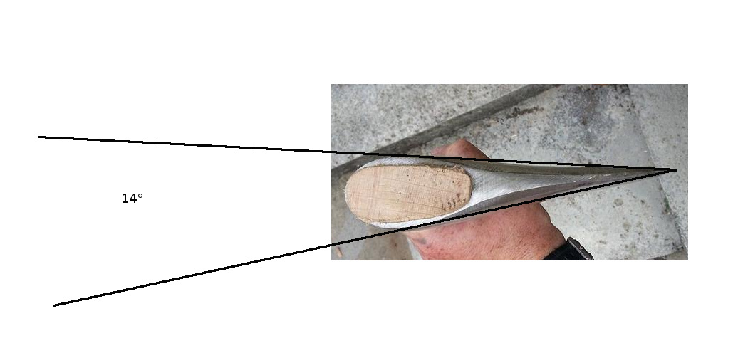

I've been looking at some axe geometry and here's what I've found. A typical pulaski makes about a 15° angle from bit to adze. The Basque axe that Ugaldie posted makes a 14° angle, wide enough that it would cause me concern. A typical American axe (I used a True Temper Dayton) makes a 12° angle. A Falci Calibria from Baryonyx makes an identical 12° angle. The long bit makes that possible as you stated in your earlier post.
Pulaski
Basque
Dayton
Falci
That Falci is the narrowest slip eye full size axe I've seen. But it's still lacking a swell and a poll. One of those problems could be fixed, the poll. In any case it's a viable alternative - giving up the swell for ease of haft removal.
Just for fun I measured the angle of my favorite long-bitted American axe, my Plumb rafting axe. It made a 7° angle.
A Collins Legitimus Connecticut made a 10° angle.
