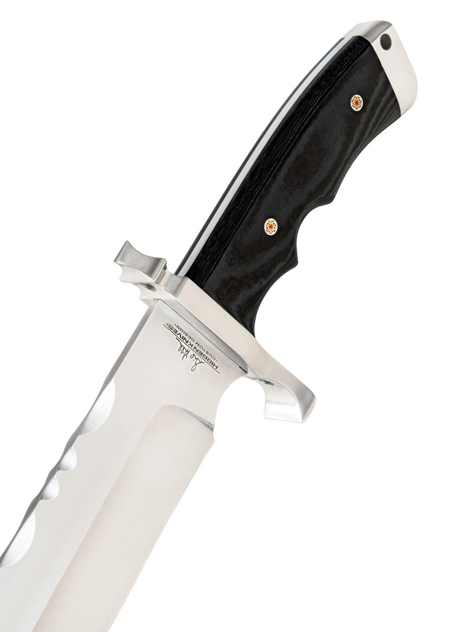

Some I can see look like decoration but others are clearly "ridged" for some use. Is that just to aid the user for not sliding too much when cutting, the grip? Thanks.
Ya it's jimping, and it's for when you're choking up on your blade and you dig your thumb into it. It's for thumb grip. Many people won't buy a knife without it.
Firstly - funny, well done all. Secondly, jimping is usually a ramped section bridging between the handle and the start of the spine, where your thumb might naturally rest as you coke up toward the blade for crafting control.
I think johnnyKnives might be asking about the deep row of notches all along the spine on some "survival" knives:
http://3udbku1grxyaflo81itpgvt6-wpengine.netdna-ssl.com/wp-content/uploads/Rambo-II-knife.jpg
Often called "jimping" because the knife maker is aping other designs and doesn't know what it is for.
If the row all down the spine ever had a use it was most likely a "sword breaker" attempt. The deep notches catch and lock on to a blocked blade in a fight and then twisting the knife either strips the knife from the opponents hands or snaps their blade. You would need a very heavy blade and quite long to get leverage... not sure it could really work against a modern combat knife.
Once again - well done on the lols.
Jimping is an admission of a design failure. It serves a purpose only on poorly designed knives. Otherwise, it's just there for marketing.

on some knives, what
may seem like some decorative custom work on the back of the knife spine
may be more than j6st fancy wavy
hollowed indentations, but rather
for allowing some flexibility
or lateral stress relief.
vIsAAOSwrZBcBfJ2
1. Yes the OP got "an" answer.
Not the answer IMO. I found this thread when curious if anyone knew what those ridges were doing.
2. Nothing wrong with wavy notches for decoration. But they do not improve the performance of the blade. The missing metal just creates a focal point for stress tear propagation and so weaken the spine.
3.Some people like the jimp. Some like to keep a grasp of their own handle, some get right up all in there... a mans life choices are his own. Live and let live.
