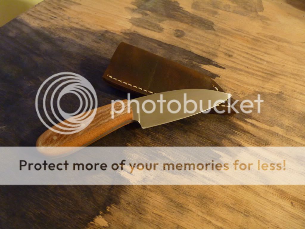

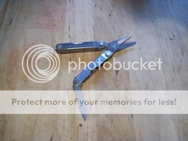

I generally prefer something with a 4"-5" blade and confortable handle..Fairly pointy with a bit of belly..Ive used everything from a case muskrat to a butcher knife and this one right here.. I left my knife in the truck and all I had on my was this leatherman micro with about a 1 1/2" long blade..
I gutted a 200+ pound nine pointer with this thing.Opened him up easy but the attached internal organs were a bit of a challenge...Just kept sawing till it all came loose..

Wow...
That sucks....
What kind of hick (er... "Appalacian-American" if you find the other term derogatory, which I personally don't) forgets his knife in the truck?? :p
(:thumbup: to the Latin in your signature, btw)
Hillbilly if you please :D I place the blame squarely on the shoulders of my hunt'n buddy that morning;) After I got thru hauling him on my 4-wheeler to his stand I was running late getting to mine..Everything was just off kilter that morning..I could have rode back and had it in 5 minutes but i thought "What the heck, Ill give it a try"..
