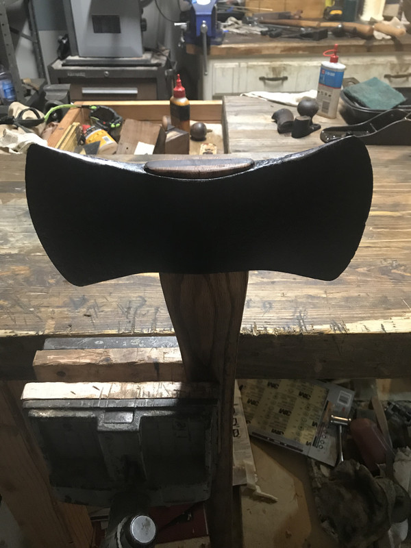

I couldn't stand having a nice ol' e&s cruiser just sit there. So i made an honest to goodness user out of it. It'll be my new "wheeler axe". Had a huge chip and a smaller chip off the heel.
I'll post more of those pics in the "what did you sharpen today" thread. The eye was also deformed from someone using it as a hammer... I did straighten it out somewhat and this pic is during that process.
Anyhow here she is! Ready for work.
I realize that where that chip is still missing is a weak spot so I filed about a 40° in that area. I'll not be afraid if this one gets banged around and so it'll end up being more useful that a perfect one! Have a great evening all!

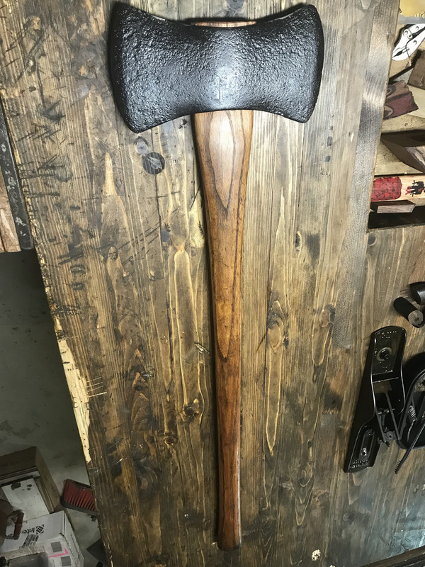

I found this the day after a desperate plea in an unexpected place. :)
3.25lbs, haft wound up 34" for now (until I can make or find a 30-32" with sexy curves. This is a reworked Ames haft. I could only take a bit off the top, but I cut almost 2" off the bottom. Thinned out, re-shaped, octagonal from the belly up, etc. I haven't put a finish on it yet, I want to stain it nutmeg first.
20190509_061403-1011x2078.jpg 20190509_031110-1209x1612.jpg 20190509_024426-1209x1612.jpg
The pics of the head: Just to show how two minutes with a med then fine niolox wheel will knock off red oxide without killing patina. Also the grind didn't show up well in the wall pic.

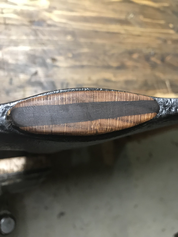

Drove home a Yankee Josh Yankee Josh Yellow Birch wedges.
That old dry handle really sucked up the BLO. I glued that split below the shoulder.
