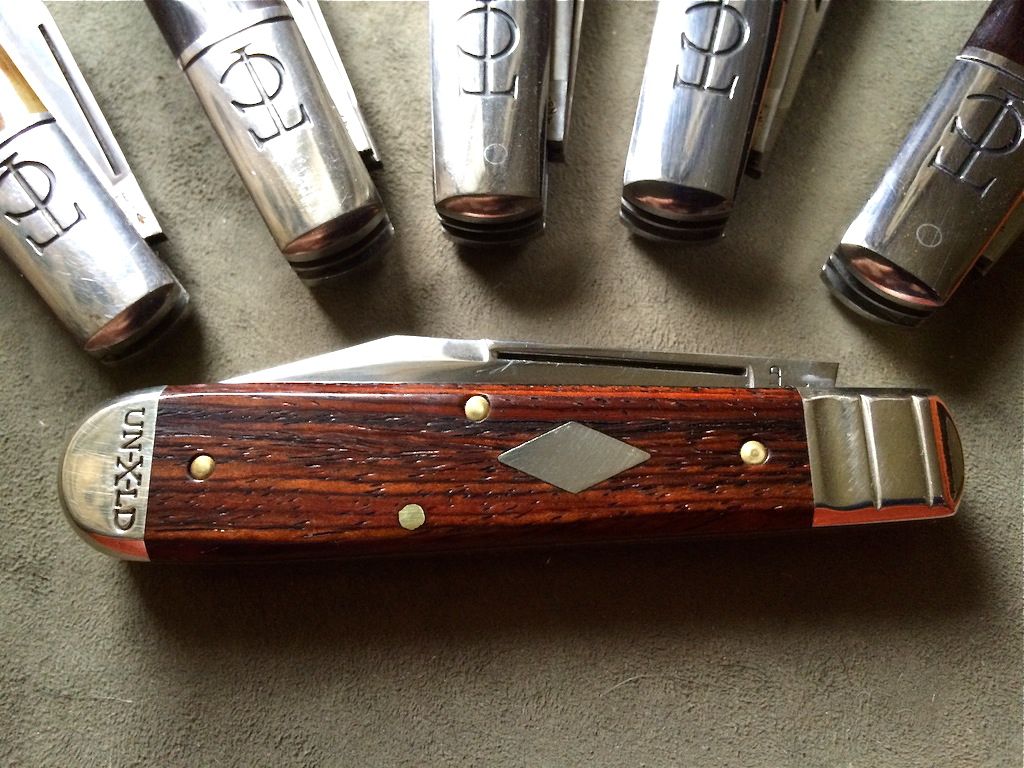

Never heard of Bocote referred to as a Rosewood. In addition to your "Rosewoods" above, and Cocobolo, don't forget African Blackwood, aka, Dalbergia Melanoxylon - http://www.wood-database.com/african-blackwood/. All the Dalbergias share some interesting characteristics when worked. I really dig the smell - it can be somewhere between vanilla and cinnamon. Turning them on the lathe for say drawer pulls, because of the waxy/oily content, just polishing with fine grit papers past 600 and then holding a cloth with some Ren wax is about all thats needed to finish. The negative is that some folks develop a really nasty allergy working with these. My fav dovetail saw has Cocobolo handles and there's something very pleasing about grabbing hold of that one. Cool, smooth, weighty/substantial - not rational, but there.
Bocote's interesting, when milling the sawdust is distinctly yellow. A bit of BLO turns it darker towards light brown and over time it just gets richer, lovely honey towards reddish. Cocobolos start out orange to red but grow towards a more uniform brown over time. Its a little disappointing given how beautiful the color is when first milled and finished.
