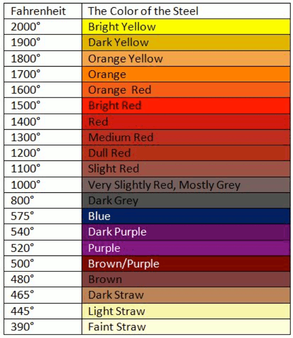

Color varies by the observer and the amount of ambient light, but dull red sounds too low for the blade to harden. The color wanted is a bright cherry red - around 815°C (1500°F) is a good target. It sounds like you needed more air than you were using.
Did you test the edge with a file to see if it hardened?
Increasing the temperature of the blade does not increase the hardness. It has to be over 780°C (1440°F) to harden. Otherwise it stays soft. Overheating a blade won't increase the hardness, either. It may damage the blade is n=many bad ways. You have to learn the right temperature and try to achieve it every time. It take some practice.
