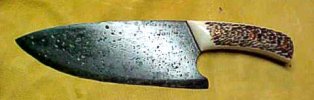

Hey Cray, here's a Chef knife I made several years ago from a cross-cut saw blade. The handle is white corian with a jigged bone pattern in it. I left the jigged portion kind of rough so it would take the stain better. I used dark brown leather stain. It works great. I've been using this knife for almost 6 years and the corian wears well and won't absorb any odors and just keeps getting nicer looking just like bone will. Give it a try if you've got some.

Max you amaze me. How do you get the Corian to take the stain. I've tried and the only thing I've been to stain it with is essence of cigarette (Bunch of cigarette butts sun rendered in a jug of water) This also kills garden pests very well but I don't like it all over my hands.:eek:
I guess the secret's in the dye Peter. I use Fiebing's alcohol based leather dye. I suppose the other reason it works so well is because I use a dremel stone to carve the jigged bone pattern into the corian and leave the surface rough before staining. Then I let it dry completely before cleaning it up with steel wool and my satin finishing wheel. Finally, I seal it with straight boiled linseed oil and believe me, it stays put.
I just finished up another one of those chef knives yesterday and had to use black because I was all out of the medium brown. Hey, I was really surprised with how good it looked. I think I like black better because of the contrast with the cross-cut saw blade. Go figure!
Thanks Dork. I've found that to be my favorite kitchen knife. The only other one I need is a Wharncliffe paring knife and I'm all set. You should see that big Chef knife slice tomatoes. It's sharp even when it's dull! :eek:
