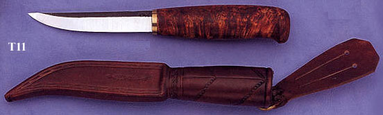

Hi guys,
What is the (Silver steel) in this kellam knife? Do you think it has a scandi or a secondary bevel edge?
http://www.kellamknives.com/index.php?main_page=product_info&cPath=1_33_46_47&products_id=10
Sort of "premium" material for forged puukko blades. I have a hunting Tommi with blade of silver steel and it is by far my sharpest knife ever.
