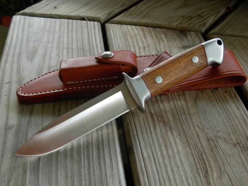

I was working on a kit knife today, and had real trouble sanding where the wooden handle hits the guard - even a 1 by 30 belt grinder cant get in there too well. The dremel sanding drums are too hard to control and too rough/small for me. I didn't try a drum sander on the drill press, is that the way to go? I just put a lot of elbow grease into it and will have to live with some imperfections. Here is another guy's work on the kit I'm talking about:
