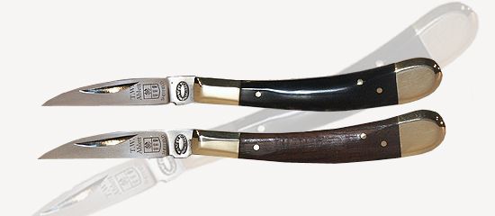

The Ettrick is a very traditional Sheffield pattern, which some claim goes back to the 1700’s. It’s name comes from the Scottish Ettrick Valley, where it was used by sheep farmers. It is a sort of Swayback Wharncliffe, but classic Ettricks have the blade set so that the whole knife (when open) forms a sort of lazy ‘S’. They may also appear to have a blade which is shorter than the length of the handle might suggest. Should be an interesting thread Charlie :)
A couple of examples pulled from the internet (I don't actually own one! :D )
Thanks Jack!
The blades seem to vary, from a straight edged Wharncliffe blade, to a (that word again) "lazy" curved pruning blade. Do both variations fall into the Ettrick category?
Also does the term "Ettrick" appear in catalogues or other print media from previous centuries?

Hi Charlie, in my opinion the edge should be straight, and the knife have that serpentine shape, which the Arthur Wright knife above shows well. Taylor's claim that the name appeared in one of their old catologues, pre-dating Rodgers 19th century popularisation of the Wharncliffe blade shape, but I've not seen it.

LOL! It's a very ergonomic pattern Charlie, the serpentine shape works well, and it allows you to make full use of the straight blade. When I was at the Abbeydale Industrial Hamlet in Sheffield a few months back, I came across a display of Trevor Ablett's knives. The place had been shut for about 10 years and they hadn't put the prices up! I snapped up the only Sheepsfoot at a bargain price. All the other knives were Ettricks and I wish I'd got one now! I was due to go back with Duncan the following week, but we ran out of time, and the place is now closed until next April! Let me know if you want one though :)

The Internet throws up a wall of information and disinformation...and the origins of the Ettrick seems obscure. I've heard some claim that the then James Stuart-Wortley, later Baron Wharncliffe and his gamekeeper came up with this knife as a general work-knife and even gutter of small animals. It had of course a 'Wharncliffe' blade, allegedly his own commission from his association with John Rodgers in the 1820s. On the other hand, some argue the Ettrick was well established before all this anyway, this is too is plausible. Ettrick the area has literary associations, James Hogg the Scottish poet and 'Etrrick Shepherd' as he was called. Whatever, it's undeniably a handy knife being useful as whittler,pruner/general knife. It seems to be an idiosyncratic native to the British Isles, not much seen elsewhere.
