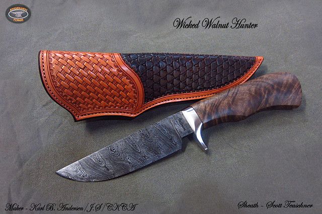

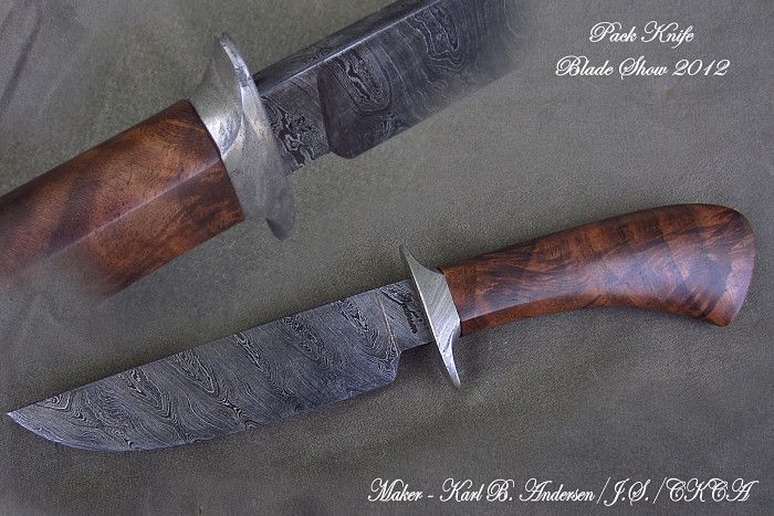

Nice Twist Karl,
Here is the one I etched this morning. It will go into my archived bucket do to a buckled edge
119 layers of 1084 and 15n20
Hey David,
Looks like your 119 layers came out GREAT! Karl's 300+ layers looks WAY cool too! I hear ya about the layer count question. What about the layer ratio variable? What are you doing on that score?
