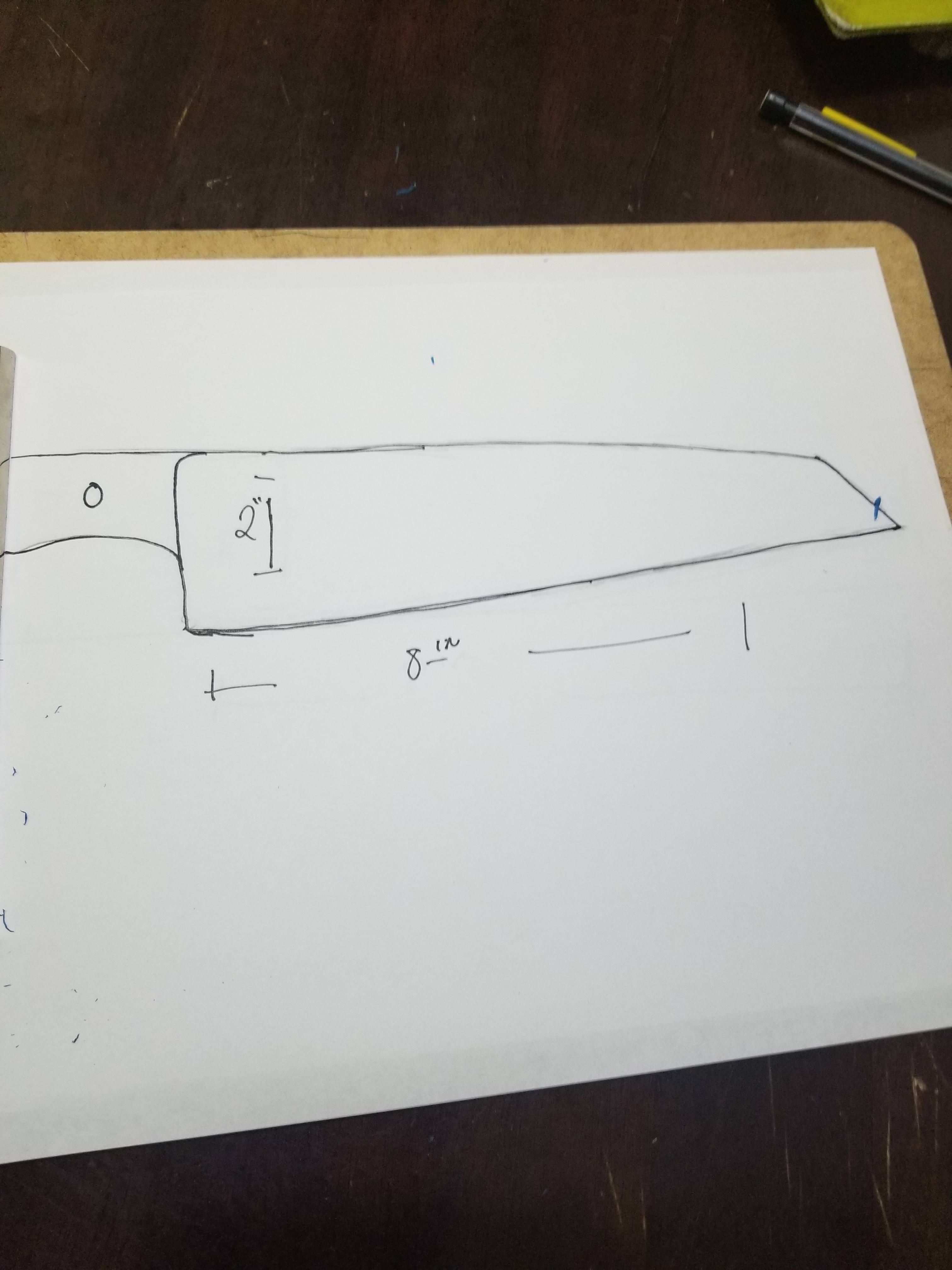

So I would like to try my hand at forging some kitchen knives. Was wondering what you experts look for in a good kitchen knife. Steel type, blade length, handle length, wa handle or full tang, heel height, spine thickness etc. I wanna make a great product but I don't know any chefs to bounce ideas off of.

I was told that when you rock the blade from the tip to the heel you should feel a definite "stop" as you hit the heel. The radius of the curve of the blade should increase as you go from point to heel so that it almost looks straight from a profile view but as you look down the edge of the blade you should see a gradual curve.
I suck at drawing and am definitely better with a hammer and grinder than I am a pencil. So hopefully the real thing will be more refined

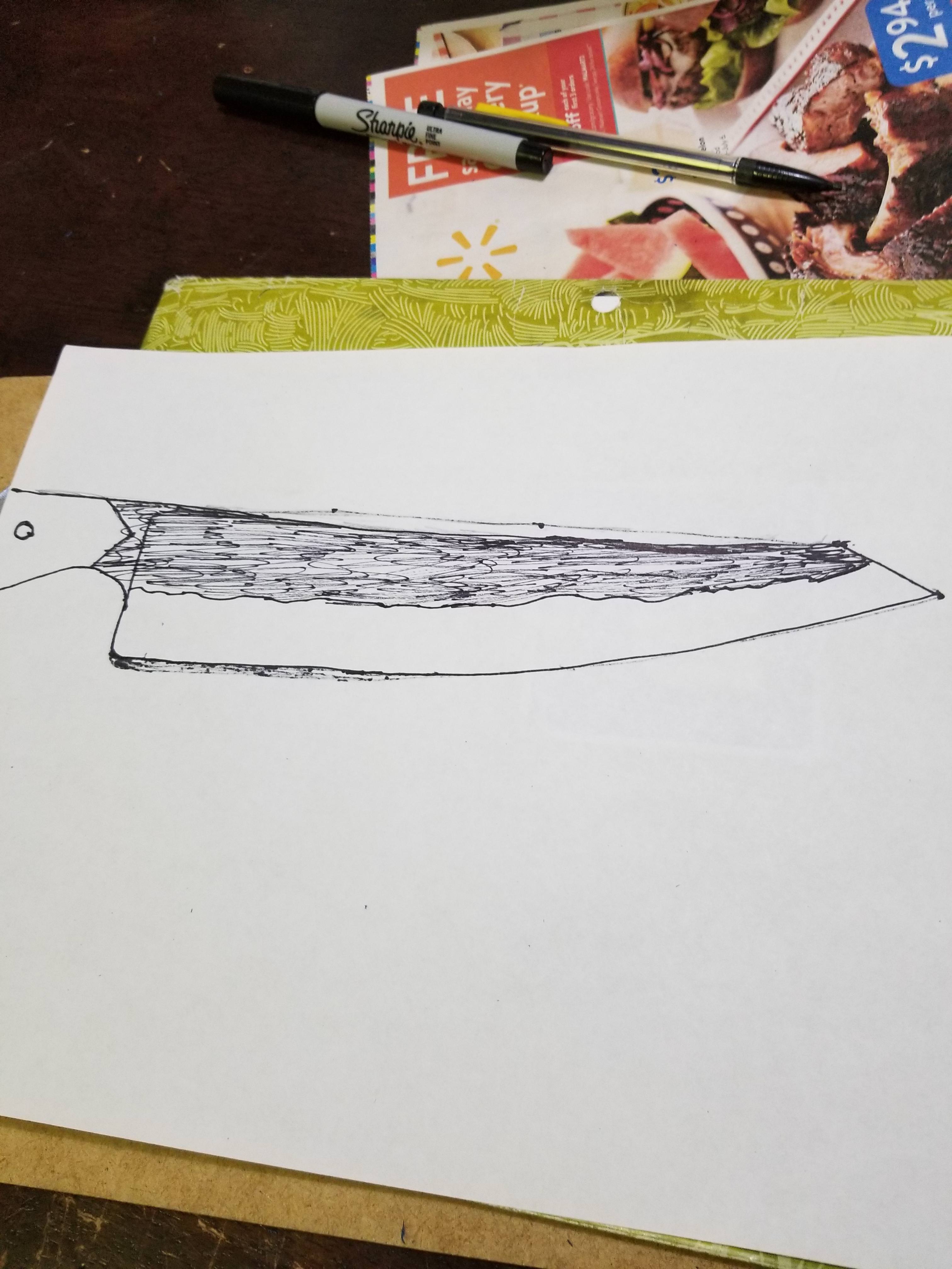

I'd like to try and stick to the Japanese type of knives. I'm just getting into cutlery so I'll definitely do some more research. But It makes sense that pro and home chefs prefer different styles
Too flat at the tip and too much curve near the heal.
I recommend that you contact a retailer of Japanese cutlery and have them send you the profile of a known quality knife.
The profile of a kitchen knife is more important than other types of knives.
Hoss
Don't reinvent the wheel. There is very little variation in profiles (outside special purpose blades) for good reason. Cheap Walmart kitchen knives often have perfect proportions and shapes they're just poorly executed in crap steel or too thick etc.

You can google gyuto and grab some images. Shigefusa is hard to beat for classic profile, but there are others that are great.
Grab a profile image, then zoom in/out as needed until the image on the screen is the size as the knife stated in the pic. Then trace.

I would recommend against the k-tip. It can get crazy thin and fragile. Work up something in the 180 - 200 mm length to start.
Your learning curve will move faster if you start with shorter blades. 50 by 180 is a really good blade size.
